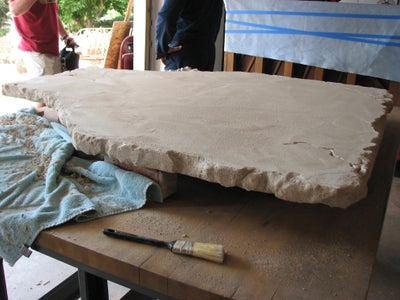

First, cut a 4' x 8' x 3/4" sheet of OSB in half. Glue and screw them together, using Liquid Nails or other construction adhesive and 1-1/4" drywall screws. If you want an unusual shape, like we have here, cut to shape before you glue and screw.
Next, staple 15 lb. tar paper to the top and sides. This prevents the water in the concrete from absorbing into the wood, ruining both the wood and the concrete. Staple metal lath to the top and sides to help the concrete stick to the tabletop.
Use styrofoam or 1" x 4" boards to make a form around the tabletop. Pour concrete about 1/2" thick on the top and about 1" thick on the sides. Smooth with a trowel.
As the concrete cures, you can add decorative touches, such as the cracks you see tooled into the surface. As you can see, the edges were chipped with a hammer. Play with it to your heart's content. Be prepared to patch the concrete if you chip off too much.
