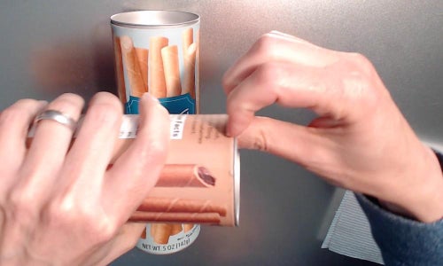

But some things that might seem like good conductors have enough of an insulating coating to prevent charges from getting through. I've had good luck with aluminum pie pans, aluminum foil, and lids that look like bare metal. But the metal ends of Pringles® cans, or tuna fish cans, or lids from jars of pickles or spaghetti sauce were less effective. If you find that particles stick to the top plate rather than bouncing off, you have an insulating coating thick enough to weaken the effects you're looking for.

The clear walls need to insulate against charges flowing; and at these voltages, some things conduct that you may expect to be insulating. For example, most glass jars and glassware are made of soda-lime glass [3], which strongly attracts water, and doesn't work for some electrostatic applications. Instead, most (but not all) plastics work well. (The borosilicate glass used in chemistry labs, and some types of "crystal" glassware are more expensive insulating options.)

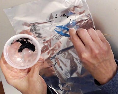

Step 2: Make the Jumping Particles
To jump easily up and down, you want something lightweight and electrically conducting. My favorite is styrofoam - a staple of static electricity demonstrations. If you want it to be as sensitive as possible, the styrofoam should be as small as possible. A great source: microbeads. I got plenty from a pillow, but you can also buy it from craft stores. Larger pieces around a half inch in diameter (cut from styrofoam packing peanuts, or bean bag fill, etc.) also work very well, and make a more dramatic noise.
Of course, styrofoam works so well for so many electrostatics demonstrations because it's a good electrical insulator that doesn't readily absorb moisture. How to make it conducting? Some people coat it with graphite, but I've had very good luck with black calligraphy ink. [5]
I used:
  • A disposable cup (I used a fruit cup - cleaned out, of course.)
  • Calligraphy ink
  • Styrofoam microbeads
  • Toothpicks
  • (Optional) Tweezers. Choose tweezers you don't mind getting coated with ink or can clean well.
  • Aluminum foil

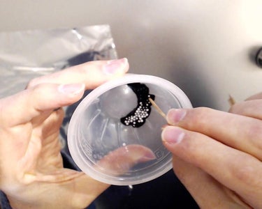

Steps:

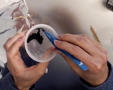

  • Drip a few drops of calligraphy ink into the cup.
  • Drop several styrofoam microbeads into the ink.
  • Use a toothpick to roll them around, to ensure they're completely coated with ink.
  • Use a toothpick to roll a bead out of the ink (to let most of the excess ink drain off). Use the tweezers or a pair of toothpicks to remove it from the cup.
  • Place the bead on the aluminum foil to dry. Roll it around so the ink doesn't pool at the base.
  • (Optional) While drying, roll the bead every 30 seconds or so. This helps prevent the dried bead having any exposed sytrofoam (without an ink coating) on the base - which tends to cause the beads to stick to the walls of the chamber.
  • Repeat until you have as many beads as you plan to use.
If using larger pieces of styrofoam, the process is very similar. You may get a more even coating of ink by using a paintbrush to get ink into voids or bubbles in the styrofoam, and by "spearing" it with a toothpick and drying it in the air, instead of drying on aluminum foil.

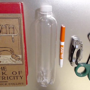

I used:

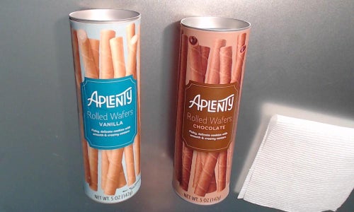

  • Two metal lids from cookie tins

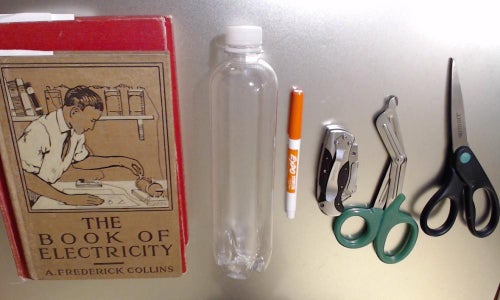

  • A (clean) bottle of Sparkling Ice® brand sparkling water
  • A dry-erase marker
  • A sharp knife
  • Scissors
  • Blocks/books/etc to use as spacers
  • Optional: orange oil-based cleaner

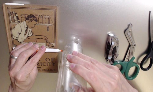

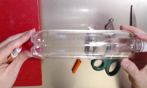

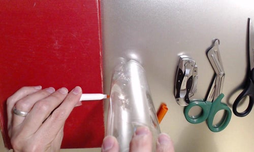

First make the plastic ring to use as the side walls:
  • Decide how far the plates should be separated. Closer together will be more sensitive to a wide range of voltages, but is perhaps less dramatic. And the space should not be too small: otherwise, you risk the particles "shorting out" the plates. At least 3 times the diameter of the jumping particles is usually OK. I chose about 2 inches, since I'd tried a variety of distances (before gluing) and found that this worked and was easy to see. You'll probably have better luck with a smaller gap for your first attempt.
  • Remove the label from the bottle, and clean the sides if necessary. Cleaners based on orange oil usually do a good job of removing adhesives.
  • Use books (or other flat objects) to give a consistent space between your table and the dry-erase marker. The bottom book should be thick enough to allow you to draw on the smooth part of the bottle (above the bottom rounded section). The top book should be just as thick as your planned thickness for the Hailstorm. Mark the bottle at both levels.

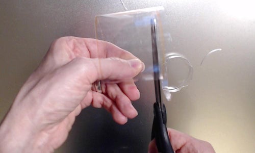

  • Use the knife to cut slots into the bottle, then use scissors to gradually trim the plastic away until you match the lines.[6]
Again, many other types of plastic jars and plastic bottles work well; it's best to try it out before committing to gluing it all together. The assembly looks a little cleaner if the plastic is around the same diameter as the metal plates; but your hailstorm will work just as well if the plastic is smaller than the plates.

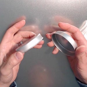

Then get the metal plates:
  • Pop the lids off of the tins.
  • Clean them.
If your lids work well, that's all there is to it. As noted above, you could use many other things for the plates. (For example: cut and sand wooden disks, then paint them with calligraphy ink; wrap anything in well-smoothed aluminum foil; etc.) But (as described above) some metals have an insulating coating that reduces the response of the jumping particles to voltages. So, try it out (with a quick non-glued test) before moving on.
[6] You could use the knife directly against the bottle, without ever drawing lines. That gives cuts that are very clean, and there's no wasted plastic, but it takes more time and is a little tricky. If you do, hold the knife as described for the marker, and run the bottle against the knife. Gently press the bottle against the knife, and rotate the bottle. Cut a groove and continue turning the bottle until it is cut completely through. (It's much easier to get a straight and smooth cut by allowing the blade to make several passes over the bottle, rather than trying to make a single cut.) When making the second cut, it helps a lot to stuff the bottle with paper or a piece of a pool noodle, so it doesn't collapse under the pressure from the knife. [back]

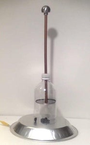

Step 4: Assemble It

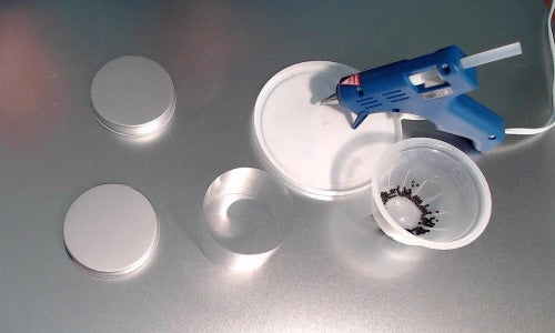

You will need:
  • All the parts made above

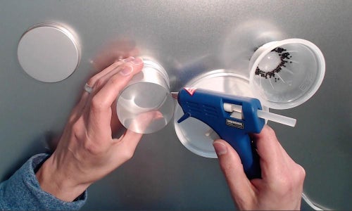

  • Glue. Many types will work; I chose hot glue since I had some on hand, and it solidifies quickly.[7]
Steps:
  • Use a small amount of glue at 2-4 points to "pin" the plastic ring to one of the lids.
  • Run a bead of hot glue around the edge to seal it.
  • Wait for the glue to cool.
  • Pour the jumping particles into the "cup" you just made.
  • "Pin" the remaining lid to the pastic ring with a few more dabs of hot glue.
  • Run another bead of hot glue around the edge. Try to avoid having any of the beads touch any glue that seeps through.
  • Once the glue cools, your hailstorm is ready to use.

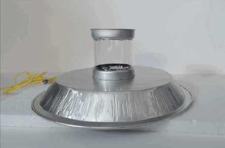

Step 5: Charge It
If you use your Volta's Hailstorm in low-humidity conditions, there are a lot of options, as long as both plates have a path for different charges to flow. Some of them you probably already have at home. For example: rest the bottom plate on a conducting table (or a sheet of aluminum foil that you touch with one hand). Then charge the top plate with a comb that you've rubbed through your hair, or a brush that you've run through cat fur, or a balloon that you've rubbed against your hair or a wool sweater, or a piece of PVC pipe that you've rubbed against wool, or clothes that you've just taken out of the dryer (that have a lot of static cling, which tends to happen if you have very different materials tumbling together, like wool and synthetics).
For a more dramatic demonstration, "classic" forms of electrostatic generators, such as a Van de Graaf generator, a Wimshurst machine, or (the easiest to make at home) an electrophorus (shown in the second picture above) also work well - but are less likely for you to have already. (But you can buy some rather inexpensively, such as the Fun Fly Stick™.)

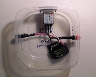

Finally, if you want to make sure it will work in any weather conditions, you can connect the plates to the terminals of a negative ion generator. That's what I did when recording the videos above (since I did it in fairly humid conditions).[8] My method: put a block of styrofoam on a table, followed by an aluminum pie pan. Clip the pie pan to the negative terminal of the negative ion generator - that will be the charged plate. Then, touch the top plate with my finger, or another conducting object to ground the top plate.
[8] I purchased mine (shown in the first figure above) at The Electronic Goldmine. I have no affiliation with them; I just like some of the things they sell. You could also extract the parts you need from an ionizing air purifier, or a racket-style bug zapper (or just run wires to its terminals). [back]

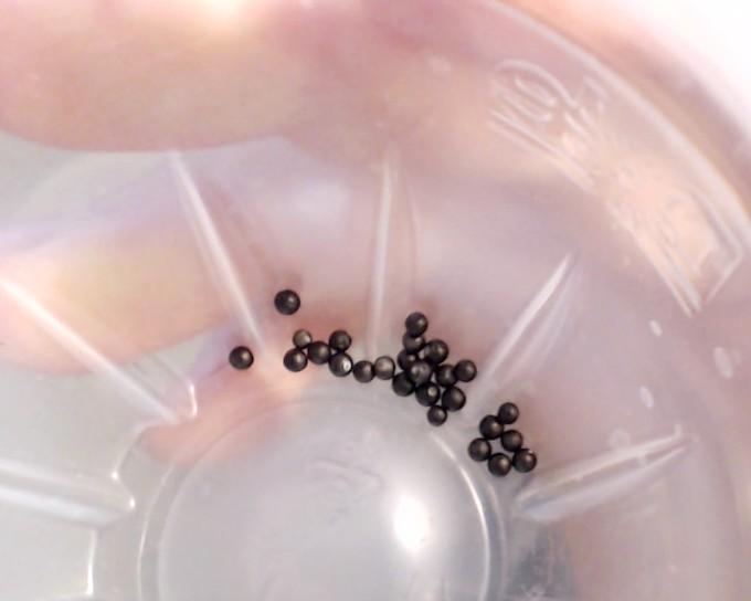

If it's not working for you, the most likely issue is a failure to get enough of an electric charge to test. You generally need enough charge that you can hear and/or feel a spark - so this tends to work best in cool, dry months. If you buy a negative ion generator and connect the proper two wires to the two plates, that guarantees you'll have something that works, no matter the weather.
If you can't, make sure the bottom plate is grounded (e.g. resting on a metal pie pan that's touching something big and conducting). Then put wool and synthetic fabrics together in a clothes dryer, and let it tumble in warm air for several minutes. You should notice the wool and synthetic clinging together very strongly when it's done. While they're stuck together, bring them into the same room as the Hailstorm. When you peel them apart, you should hear some powerful shocks. Pass one of the fabrics along the top plate (making sure it can't touch anything connected to the bottom plate). If that fails, you may have another issue.
Another possible issue is using ink that doesn't conduct. In that case, you should see the styrofoam moving around a little in response to the charge - but they'll tend to stick to the charged plates and the walls. If that happens, try a different type of ink, or little hollow balls of aluminum foil. (I prefer to make foil balls by wrapping the thin foil from Hershey's Kisses around the tip of a Q-tip, cutting it to size, sliding it off, and gently rounding it off.)
The last possible issue is using side walls that don't insulate well enough. Here's a way to test, but unfortunately it isn't perfect, and works best in dry conditions: try rubbing the plastic jar, can, or bottle against different types of things. (Tissue paper and wool are the first two things I would try.) If you can get it to "charge up" and attract thin strips of paper, then it should be a good enough insulator. If it doesn't, that still doesn't guarantee it's a bad material - but it's easy enough to try another material just in case.

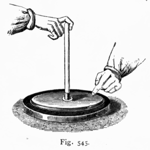

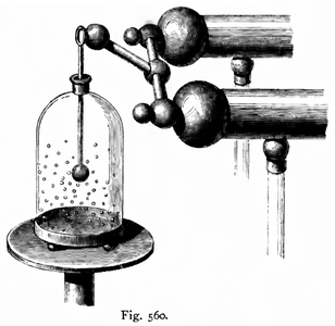

Volta's Hailstorm is named after Alessandro Volta (1745-1827). Some science demonstrations are named after famous scientists or mathematicians, even if they had no role in their development. I haven't verified this in any of Volta's writings, but I found one fairly early source (Elementary treatise on physics, published 1875) that does attribute it to Volta, saying:
   "Fig. 560 represents an apparatus originally devised by Volta for the purpose of illustrating what he supposed to be the motion of hail between two clouds oppositely electrified. It consists of a tubulated glass shade, with a metal base, on which are some pith balls. The tubulure has a metal cap, through which passes a brass rod, provided with a metallic disc or sphere at the lower end, and at the upper end with a knob, which touches the prime conductor.
   "When the machine is worked, the sphere becoming positively electrified, attracts the light pith balls, which are then immediately repelled, and, having lost their charge of positive electricity, are again attracted, again repelled, and so on, as long as the machine continues to be worked. An amusing modification of this experiment is frequently made by placing between the two plates small pith figures, somewhat loaded at the base. When the machine is worked, the figures execute a regular dance."
Volta certainly did electrostatics experiments, and his theory of hail involved changes in both heat and electrical capacity as a droplet freezes - so it's very plausible that he used this demonstration in his discussions of hail.
In this figure (reproduced above), the upper electrode is a sphere - which works well, although the response is somewhat weaker (requiring a higher voltage) than parallel plates. And unlike most modern Hailstorms, it uses a bell-jar shape - which seems common in several (but not  all ) other  older  examples. This suggests other interesting things that can be done with plastic soda bottles, including one with a variable gap between the plates (another one I built, shown in the second figure).
Some old references describe this demonstration as "dancing pith balls," "the electrical dance," "electric hail," etc. These descriptions are just as good, and may help you find additional references.
