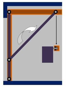

Step 4: Tilting Doors
The tilting doors are cut in 10mm MDF. They are pierced with 3 holes to make the portholes and cutting lines imitate separate panels.
They then receive ball bearings at the 4 corners.

Step 8: Rails
For overhead doors, I created rails with 10 and 3 mm MDF. They will allow the ball bearings to slide easily.
I also added a magnet for the doors to stay open.
