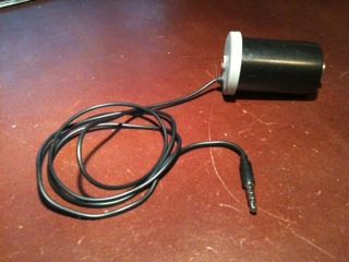

- 1/4 inch female mono jack socket. This will be used as the input for your guitar.
- 1/4 inch male stereo jack socket or a 3.5mm stereo female jack socket. This will be the output, headphones go in here. I used the 1/4 inch because I had it laying around along with a 1/4inch to 3.5mm adapter, if you prefer you can use the 3.5mm and spare yourself the adapter.
- 3.5 mm stereo video cable. The most important part.
In the last picture you can see three cables the white one came with my iPod Touch and has a built in microphone, the black one are my headphones that lack the built in mic, and the grey one is the one we'll be making.
This is why we need the 3.5mm stereo video cable, it has the same lugs as the white one. One for the mic (in this case the guitar input), and two for the headphones (in stereo were available).
Step 2: Cuting and Soldering
See those three plugs with colored rings around the plastic? Yeah, the yellow, red and white things. Those won't be needed so just use an axe to chop them off.
The red one is what we'll be using as the guitar input. So take your soldering iron and solder the 1/4 inch female mono jack socket to it. Red lead goes to hot lug, bare wire goes to the sleeve.
You are left with the yellow and white ends, these will be the headphone output, once again use your soldering iron to connect the white and yellow leads to the hot lugs of the jack, again the bare wire goes to sleeve or groung.

To make everything tidier and more resistant I suggest you use a small enclosure.
I used a film canister, I made a hole in the bottom and another in the lid, for the input and output jacks and a hole in the middle where the cables get in the canister.
In the last and first pictures on this instructable you can see the whole setup, ready to be used (no guitar present since I couldn't fit it in frame and still show the app.

I originally got the PRS connector and it sounded terrible with IK-Multimedia Amplitube as well as the new Ampkit apps on my iPod touch. It definitely had issues with the input impedance mismatch. I recently got the Peavey/Ampkit iLink interface and it is a drastic improvement. The iLink is actually active and runs on 2 AAA cells it solves the impedance and feedback like problems of the PRS interface (I have not tried the iRig interface as they were very slow on delivery). I then went back and tried the PRS interface with both a compressor and a clean boost pedal set very clean and that seemed to solve a lot of problems. I believe that incorporating an opamp IC or a discrete transistor circuit into the interface would help immensely with the overall sound quality. In any case the iPhone/iPod touch are great for guitar when I am stuck in bed. Then I added a Vibe-it speaker device (makes any large hollow object into a speaker) stuck to the guitar and it makes beautiful controlled feedback like having an Ebow on every string. I also have hooked the interface output to my bedroom guitar amp (Ampeg Gemini II from the 60's) and it works very well.

You should probably mark the wires before you chop the connectors off. Then you'll know what to solder later.
Reply 11 years ago on Step 2
@dirq If you look at the pictures you'll see that the wires inside are colored to match the connector they were formerly attached to.
