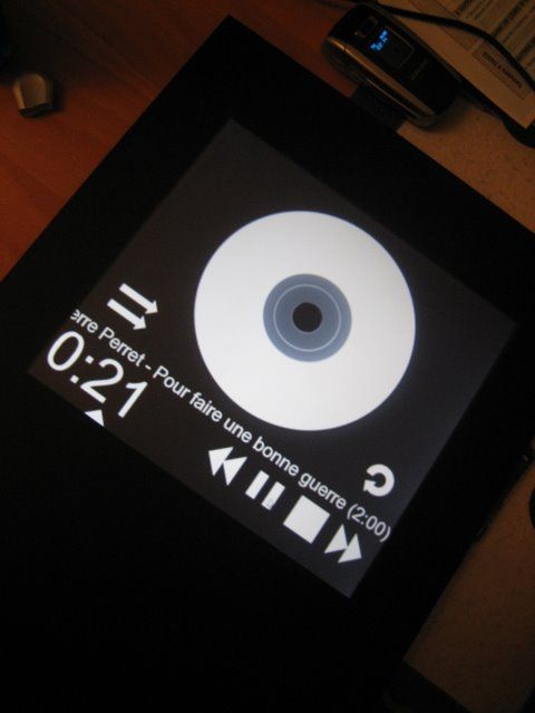

After transforming an old laptop into an MP3 player, I show you how to turn a very (very very) old laptop into a digital clock with multiple "skins"
MP3 Player
The end of the project shows you what you can do with a more recent laptop with a real graphic OS. I am curently working in improving the interface on this laptop.
This is a nice way to recycle old hardware you can found or buy for cheap.
MP3 Player

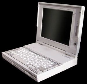

For this project, I used a very old 286 (80MHz) with a monochrome screen. This is a Compaq LTE 286. The passive matrix screen can only display gray levels...

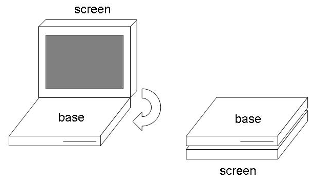

Remove the screen. I recommend you to keep the plastic enclosure and cut the edge so that you can glue the back and the laptop with the back of the screen without damaging the LCD.
So find a way to reverse the LCD by cutting the screen hinge.

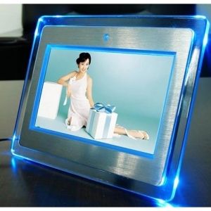

Paint the back and brush the front face to make a cool effect.
You can add some LED lightings for an even cooler like on the picture frame, but I didn't do that, too complex for me.
