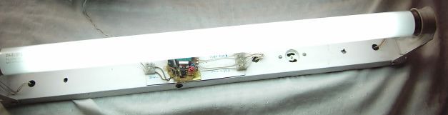

Step 2: Connecting Components & Finishing
1. Make a 5 mm whole near the voltage out put and connect the LED and Resistance as shown in the circuit diagram, observing the polarity of the current.
2. Test it by hooking to the mains power socket.
3. Finally glue the diffuser on it.
