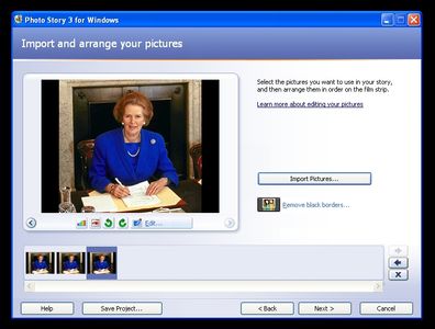

3. Open up Photo Story 3. On the opening screen NEW PROJECT is selected by daefault. Click NEXT and then IMPORT PICTURES. Load up some pics. Click NEXT. I suggest you ignore the REMOVE BLACK BORDERS thing: I find it just messes up your formatting. So when it asks incredulously if you REALLY want to continue without removing black borders just say YES. Unlike Barbara Bush.
For this example, we'll be making a slideshow about three British prime ministers. Here they are loaded into Photo Story. You can see that the first pic is showing in the main screen and all three are showing in the strip at the bottom.

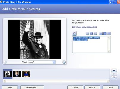

Now it says 'You can add text on a picture..' Just type some text into the box ( that's right - the one where it says type text...).
Step 4: Format Text
Maybe you could just see my black text appearing right across old Winnie's waistcoat?
Click on the AA symbol and you can change font, point size and colour. Click on the buttons to the right and your text centres, ranges left or right, appears at top, bottom or middle of the frame.
NOW we can see the writing... Tasteful, innit?
Notice under the box where Winnie appears a button saying EFFECT (none). We'll get to that later.

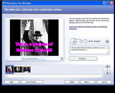

Step 5: Have a Look at What You've Done
Now up comes a screen dealing with various things.
Notice that under WSC's tummy it now says CUSTOMIZE MOTION. We'll get to that later. The red button, the TYPE NOTES message and the STOPPED message are for voiceovers. We'll get to them later too.
Right now, click on PREVIEW to see what we are getting at. A new little window opens up, and I hope you will see our three great leaders (or whatever pics you have loaded up ) appear in succession with some panning and zooming effect added. It already looks SO much better than just a succession of jpgs.

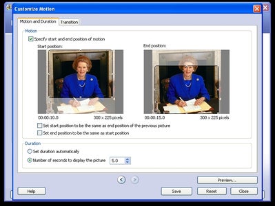

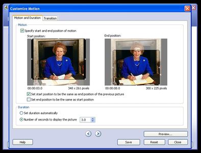

Done that? Great. You'll see we've been dragged back to the voiceovers screen. Let's see if we can't make those zooms and pans a bit more logical. Click on CUSTOMIZE MOTION please. You should get something like the first screenshot.
From the top, then.

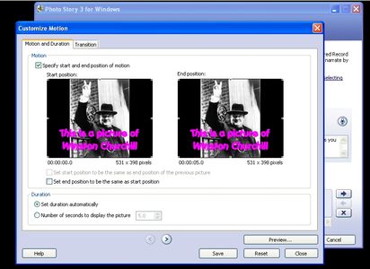

The tick box SPECIFY START AND END POSITION OF MOTION allows you to open up a dialogue handling where images start and finish. Click in it please. See how the box below opens up? (Second screenshot.)
Now you can click in SET POSITION TO BE... and SET DURATION... / NUMBER OF SECONDS...
Step 7: Change How the Pic Moves in the Frame
There are little handles around the two pics marked START POSITION and END POSITION. If you grab hold of thes pics with the mouse you can move them around. Have a go. Click on PREVIEW to see what you did. Hmm. Getting sexier all the time. Fiddle around some more till you like what you have. Save.
Now click on the little > button near the bottom middle to go to the next picture and do the same again.

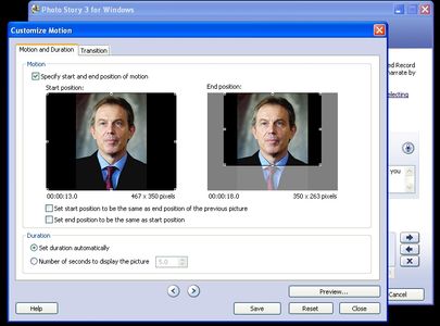

Now we are looking at the second pic (Tony Blair in my example), and it's the same deal - you can move the start and finish frames around.
There are two new things to note though:
1) the box marked SET START POSITION TO BE THE SAME...
This allows you to tell the current pic to start in the exact part of the frame where the last one left off. This gets useful later!

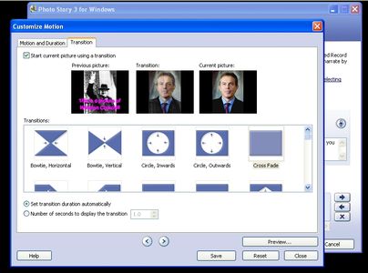

2) the tab marked TRANSITION. Click on that.
Step 9: Transitions
This window allows you to decide how the last picture will change into the next.
NB: The current picture is the one on the right and the previous is on the left. the middle frame shows the transition happening - and by default it should be giving you a cross fade.
OK, let's go nuts. Click on BOWTIE HORIZONTAL. Watch the effect in the middle window. Scroll down to the very bottom and click on WHEEL COUNTERCLOCKWISE. See what that does?
Choose something. Click on SAVE. Click on PREVIEW.
OK, now leave those jazzy transitions alone: good taste must prevail. Limit yourself to CROSS FADE, FADE TO BLACK, and a very occasional excusion into the realms of DIAGONAL UP LEFT - on your birthday. (Alright, I know you won't - but try for restraint, OK? Unless you WANT it to look like an '80s corporate video?)''
Now click the button NUMBER OF SECONDS TO DISPLAY THE TRANSITION and change the number to something else. PREVIEW. Cool, huh?

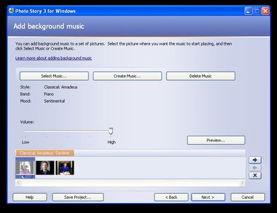

Step 10: Add Music

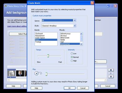

If you choose SELECT MUSIC you will call up a file selector which allows you to put in a sound file like a wav or an mp3 from your computer. Obviously you'll be using something legal.
If you choose CREATE MUSIC, you get to the next screen which gives you Photo Story's music generator. This is great fun! Let's go there.
NB: In the slideshow the music will start when the slide highlighted opens.
Step 11: Choose Your Cheesy Music, and Narrate
Have a play around with these options, and click on the go button to hear the effect.
When happy, click on OK, go back to the ADD BACKGROUND MUSIC screen, and click PREVIEW.
Crikey! What a difference the music makes, doesn't it?
This would be a good time to SAVE. Then click on the back button to return to the NARRATE YOUR PICTURES screen. Let's do a voiceover: click on the red button and speak into the microphone. (You do have a mic connected to your PC, don't you? We covered that in Step 2.)
and... PREVIEW.
Now you should hear the cheesy music AND hear your voiceover. Probably the balance is wrong, so you'll have to either a) shout or b) go to the music page and adjust the volume slider.

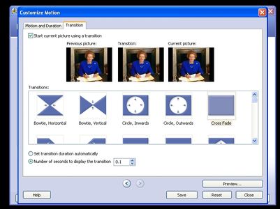

When you pan across a photo, you very often want to linger on a part of the pic: you might want to open with a held shot of the left hand side, then pan to the right and then hold the right hand side to finish. Here's how:
- Import the same pic three times.
- In CUSTOMISE MOTION arrange the first pic to stay motionless for, say, three seconds, (tick the boxes SPECIFY START... and SET END...; click the radio button for NUMBER OF SECONDS and adjust the time you want the pic to be displayed).
- In CUSTOMISE MOTION arrange the second pic to start where the old one left off (SET START POSITION...)
- In CUSTOMISE MOTION arrange the third pic o start where the old one left off (SET START POSITION...) and stay motionless (SPECIFY START... and SET END...).
- In TRANSITIONS, adjust all the transition times to a minimum 0.1 seconds to avoid shadowing
- Adjust the duration of the slides to suit (click the radio button for NUMBER OF SECONDS and adjust the time you want the pic to be displayed)

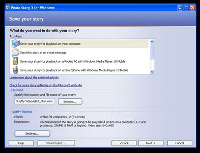

Now let's save a video. Go through the screens to the music screen, and then click NEXT. Here you choose the resolution of the resulting video (click on SETTINGS to change it) and where the resulting file will be saved. When you're happy click NEXT again and a wmv file will be saved.
