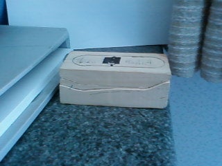

Step 2: The Mould
Take the block of wood (2x2x5) and draw on to the long side an image of the side of the board.

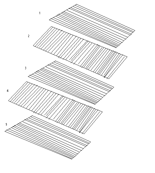

Step 3: The Veneer
cut out 5 peices of veneer or 1 ply to about the same size as the mould. 3 peices should have the grain in one direction and the other 2 should have the grain running perpendicular. Glue all the layers to gether with wood glue like in the picture.
then put the sheets together in the mould and clamp it. leave it for between 12 and 24 hours to dry hard.
