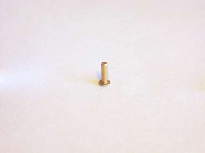

one 3/32" by 3/8" rivet, part: MS20470AD3-6
one 1/8" by 3/8" clevis pin, part: MS20392-1C7

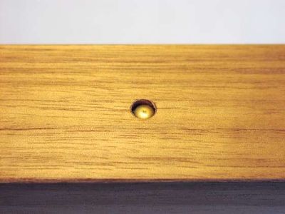

Thread the line upwards from the cube through the hole in the block on top. Pull the line upwards to remove slack, then tie an overhand knot close to the upper surface of the block, about 1/4" from where the line disappears into the small hole.
It's better to tie the knot too far from the hole than too close. If you're too far, you can tie one closer and trim the far one(s) off. If you're too close, you'll have to remove the knot so the line will fit into the hole along with the rivet.
Partially insert the rivet into the hole, leaving the head protruding enough so that the knot can pass underneath to be hidden from view. Grasp the line on the side with the cube and pull the knot down until it jams between the rivet and the rivet's hole. Remove the spacer and check the distance. Adjust spacing to your preference.
Pull the knot out from underneath the head of the rivet, trim the excess line close to the knot, and use a flame to melt the end (as with the knot on the clevis pin). Make sure the rivet hides the line from view, then push it down until the head is below the surface of the wood. A paper clip comes in handy if you need to push the rivet back out.
