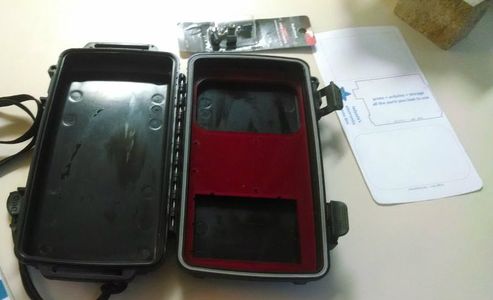

I printed the pattern on paper first and checked it against the box, arduino, breadboard and tin, to make sure that everything fit. Check!

I discovered that the Otterbox I had ordered from Amazon had one major difference to the one originally used by Adafruit - it came with a foam liner that needed to be removed. A little time and some Goo Gone for the adhesive took care of that.
I checked the fit of the insert in the box, and of the breadboard and mint tin; the breadboard's tabs did not fit exactly, but close enough with a little wiggling.

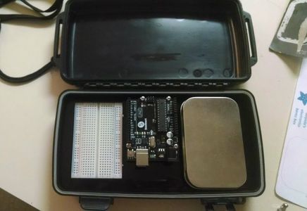

I used parts from two sets of RadioShack computer standoffs (10 mm and 20mm) to attach the Arduino. I used the shorter standoffs - just enough to lift the USB connector above the level of the case edge, so that it is easy to plug in. I needed to use the longer screws from the other set, however, to reach through the 1/4" acrylic.
I also used foam tape on the back of the breadboard and velcro tape on the back of the mint tin, so that those items would help hold the insert and Arduino in place in the box.
Once everything was assembled, I gave it a good shake - nothing moved, This is a durable, waterproof travel case for your Arduino and accessories.
