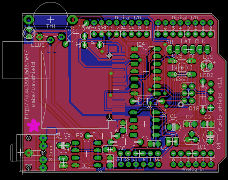

Step 4: Wire PS2 Connector to Wave Shield
On of the many nice features of the wave shield is that it provides copies of all the arduino pins (even those not used by it) in a row right next to the connectors. This provides a way to add other connections to the arduino through the shield.
When connecting to the breakout pins on the wave shield, really I was wiring the PS2 connector to the arduino, but by making the connection to the wave shield and letting it pass the connections to the arduino, it becomes easier to remove the arduino for other things. By making all the connections in this way, this project allows the arduino to just pop out whenever desired.
PS2 connectors have 6 pins, but only 4 of them are used for keyboard connections. A multimeter is handy to figure out which wire goes with each pin. After stripping a couple of inches of insulation off of the connector, I noted which color wire went to which pin on the connector.
Pin 3 on the PS2 connector is the ground wire which should go to the GND pin on the shield. Pin 4 should be connected to the "+5V" connector right by the GND.
Pins 1 and 5 are serial data and clock pins (more about that in the software step) and need to be connected to a digital I/O from the arduino. Since the digital I/O pins are on the other side of the board, the cable would have to be split apart by several inches which I was loath to do.
The pins labeled "analog" are right by the ground and power pins and are much more convenient. Fortunately, despite their names, the analog pins can be used as additional digital pins. In addition to their standard names the analog pins can be referred to as digital pins 14-19. I.e. Analog 0 is Digital I/O 14, Analog 1 is Digital I/O 15.
I wired the data pin (PS2 pin 1) to Analog 0 (I/O 14) and the clock pin (PS2 pin 5) to Analog 1 (I/O 15).
Because all the connections are all together, I was able to wrap the whole thing up with some heat shrink tubing. To provide strain relief, I like to put a bit of hot glue on the connections. Before I did this, I used my multimeter to make sure that this glue is not a conductor of electricity. This makes for an uglier (unless you are hiding a even uglier solder job) board, but helps on wear and tear on the connection. Since I occasionally remove the arduino, the wires get moved around some and the strain relief helps insure that the wires don't break off.
