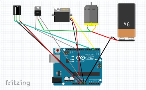

Step 2: Circuit
This is a fairly complex circuit, I'm not going to write out all of the connections here, but you can refer to the image above if you are having any trouble. One thing to note is that the polarity on the fan (the motor in the picture) does not matter.

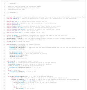

Step 5: Code
Upload the code located here to your Arduino, and make sure that all of the functions work. There are a few troubleshooting options located at the bottom of the code, but if you have any issues post them in the comments below.
* Make sure to change the values POWER, CHANNEL_UP and CHANNEL_DOWN to the values that you recorded in step 3
