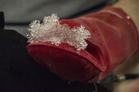

Follow the package instructions to heat the Instamorph to the desired temperature. Thought the packaging states that 160 degrees F. is the highest the Instamorph should be heated to, I found that 180 degrees worked slightly better as it made the plastic easier to work with.
NOTE: Do not pour entire package in at once. It will NOT melt as intended. Instead pour only small (~2 TBSP) quantities into heated water.
Let the Instamorph sit in the heated water for 2-5 minutes until translucent.

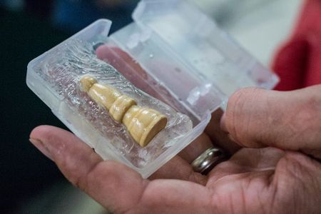

Step 3: Create Mold Using Original Game Piece
Immediately after removing Instamorph from heat source, fill the container approximately half way with Instamorph. Quickly press the game piece about half way into the Instamorph, creating the "bottom half" of the mold, leaving the game piece embedded into the bottom half of the mold.
For best results, submerge the top half of the mold into cold water to fully harden the Instamorph before continuing.
Create the top half of the mold by filling the area around the game piece with Instamorph, effectively "sandwiching" the game piece between two separate pieces of Instamorph. Fill the container to the point that it can still be sealed, leaving minimal air if possible (e.g. is should be totally "full" when closed).

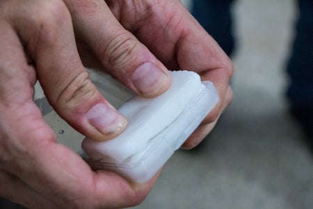

Step 4: Remove Original Game Piece and Create Clone
With both halves of the mold complete, remove the original game piece from between the two halves of the mold.
Using your hands, create a "rough" version of your game piece using a third piece of Instamorph and insert it into the void in the bottom half of the mold. Massage the Instamorph into the mold, leaving more than enough excess to fill the other side of the mold (but not too much more than you need).
Firmly press the top half of the mold over the second piece and close the container tightly. Wait roughly 30 seconds for the Instamorph to set.
For best results open the container, and submerge the clone game piece in water to allow it to fully harden before removing from mold.

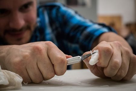

Step 5: Finish the Game Piece
Withe the new game piece created, finish the game piece as desired. Use a craft razor to trim excess from game piece. Optionally, use a fine grit sand paper to smooth edges, and/or paint as needed.
