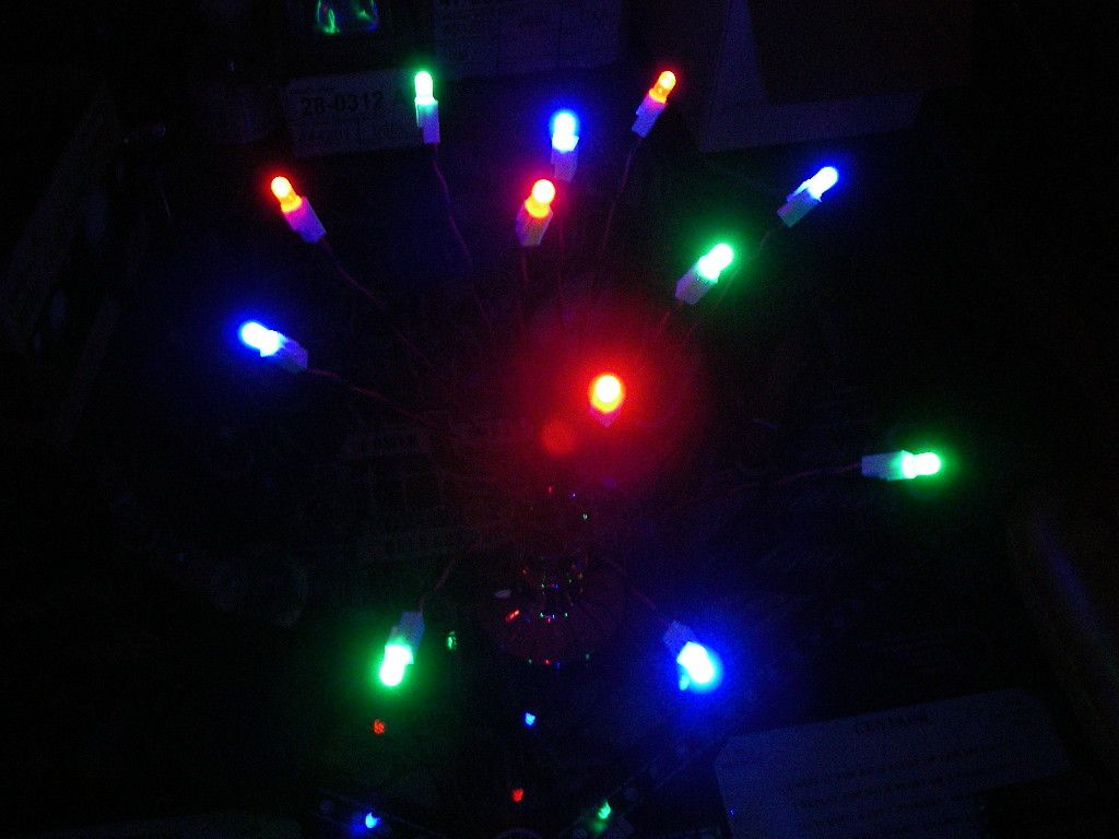

Introduction: Make a Simple LED Tester.
This is a very simple but useful LED tester that lets you test, compare and check the colour of just about any two pin LED.
