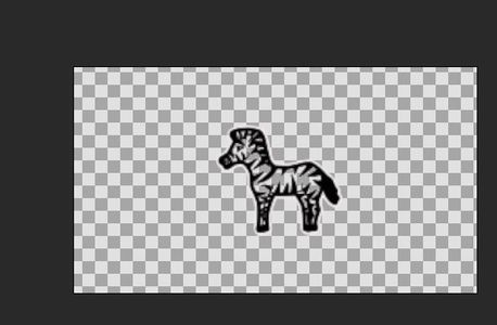

When Synfig opens you need to add an image.
To import an image you need to click File - Import then select the image you want and click import.
If the image is too big or small, click on the image and drag the orange dot up or down to re-size the image.
For this example I used a zebra.
