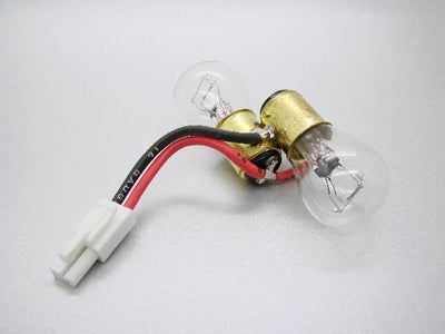

Ok, the polarity on these bulbs really didn't matter, they worked both ways. Yours may be different, but check anyway with a 9v or with your assembled part from the prior steps.
Anyway, you need to solder the positive(or negative whatever floats your goat,lol)to the bulb. The ones I used had two contacts on the bottom that where conveniently made of solder. All I did was melt them, stick the wire in it, and then solder some more on for good measure.
I found that the easiest way to do this by taking a water bottle, or soda bottle and sticking the bulb on top and holding it in place with a piece of tape. It makes the whole process of soldering to the bottom of the bulbs a heck of a lot easier!
Step 4: Step Three.
Unfortunately, I accidentally deleted the picture I made for this step, but you can clearly make it out in the one below.
Ok, take the other bulb and lay it opposite to the first bulb. You can use some tape to hold the two together. Put the negative wire in between the the bulbs and solder it in place. This was the hardest part of the job for me because the solder wasn't sticking to one side of the bulb, so I had to make it as best as I could and hold it together with tape. I suck at soldering, but if your good at it, you shouldn't have any problems.

Now, you need to complete the circuit. Cut a piece of wire long enough to reach around to the bottom of the other bulb. Make sure you strip enough coating off to make it easy to solder. I was able to slip one end of the wire under the first connection on the first bulb and fold the wire over and solder it in place(sorry no pic of that, got deleted). Or just do whatever is easiest for you.
After you secure it to the first bulb, flip it over and solder it to the second bulb.
Trim any excess, and wrap the middle in electrical tape.

Connect your battery pack to the discharger and make sure it lights up. If your using double filament bulbs like I did, make sure both are lit.
Congratulations, that's it, your done!
You can add more bulbs to the circuit if you have a larger capacity battery. Mine is a 8.4v 1100 mah battery.
Oh, and be very careful where you put this thing when its plugged in, the bulbs get very hot!!!
