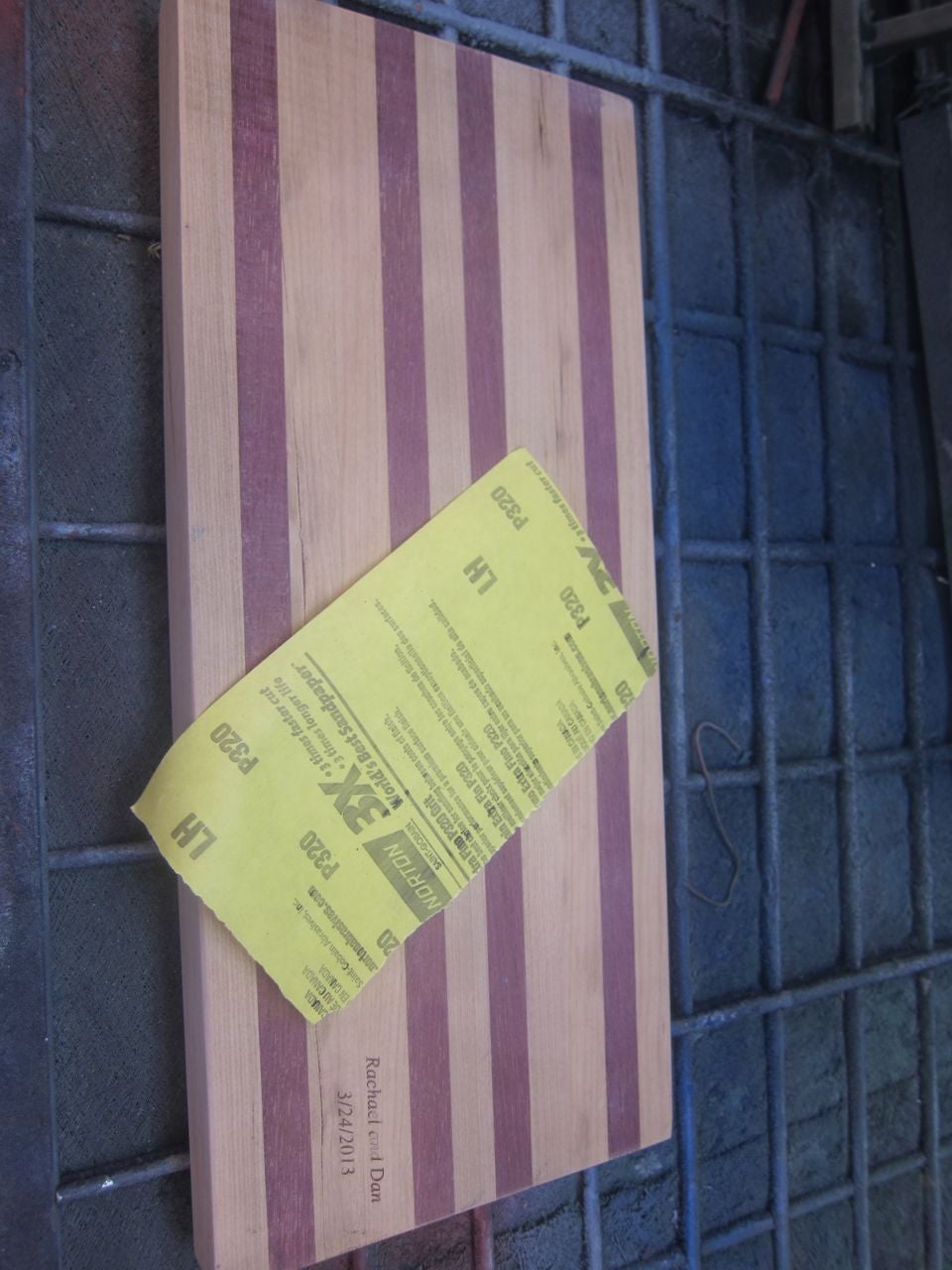

Step 3: Personalize It
Laser etching, what's not to like? If you've got access to a laser cutter and you're making someone a gift, might as well personalize it. I added their names and wedding date.
Step 4: Sand and Add a Finish
Use a palm sander to smooth everything, round the corners, and get rid of the smoke marks from the laser. Switch to sanding by hand to finish the job with a finer grit.
Put on a pair of gloves and smear the Good Stuff all over the cutting board. The directions say to wait 10 minutes or something before getting rid of the smudge marks but I've had good results just smoothing the finish off as I go. Two or three coats of finish seems to work well for the other boards I've made.
