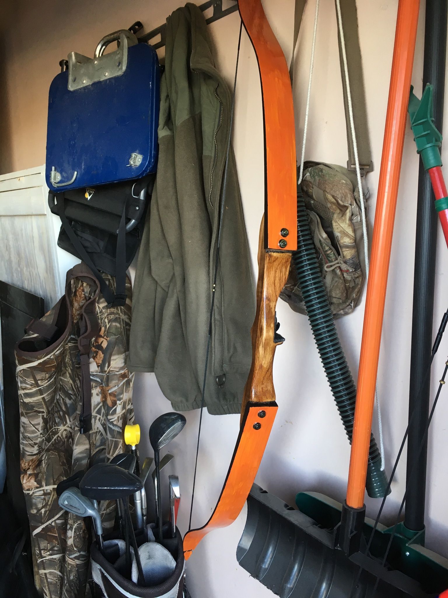

I made this pair of bows at the artist residency, Grin City Collective, in Grinnell, Iowa.
Skis are an excellent material to use for the limbs of a bow. First off, they are uniform. You won’t have to worry about inconsistencies in the material; you can expect both limbs of the bow to bend equally. This also eliminates the tedious process of tillering the bow. The front of the skis also already have recurved tips. All of this means using skis saves a lot of time.

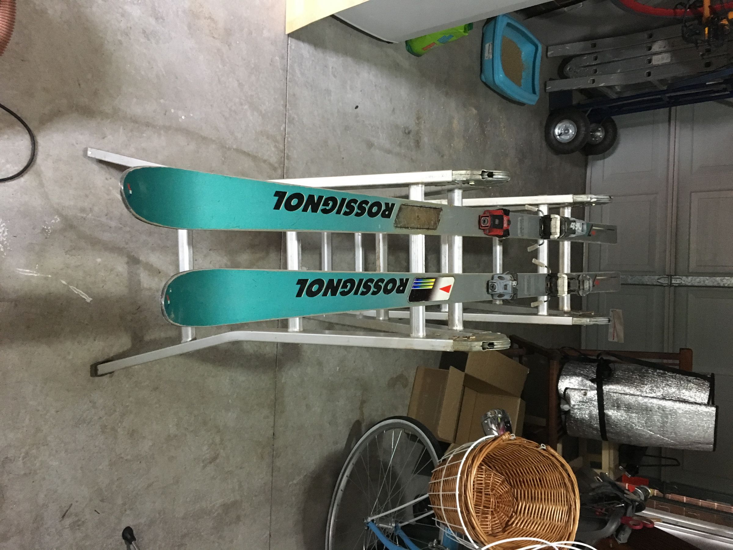

Step 1: Skis
The skis used in this Instructable are cross-country skis. The bows turned out to be between 20-26# @ 28” draw. Bows made from downhill skis will be much stronger due to the increased rigidity; I've heard reports of folks achieving >60# with downhill ski limbs. My initial goal was to make a more powerful bow but for some reason its really hard to find downhill skis in Iowa.
EDIT: I have since made a bow from downhill skis. This bow is 58# @ 28".

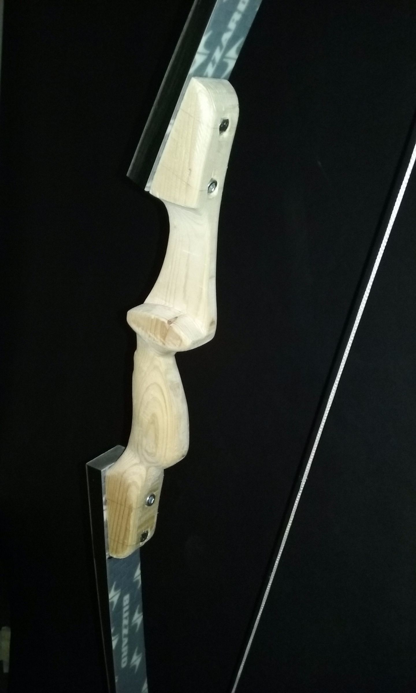

Step 2: Designing the Riser
A takedown bow consists of two limbs that attach to either side of a riser, or handle, by some hardware. The riser needs to have a flat surface for the limbs to attach, a grip for your hand and a carved out shelf for the arrow.
Here is the chance to be a creative in your design. The riser doesn’t flex at all when using the bow! As long as the riser satisfies those three things it doesn’t matter what it looks like.

The two risers I designed were about 20” and 18” long. The riser sketched on the left was designed to have only one bolt holding the limb down where the riser on the right was designed for two bolts per limb. EDIT: The drawings for the risers made in this Instructable are included as pdf's in the final page.
Note: The angle made by the vertical axis of the riser and the attached limb should be around 15˚-20˚. If the angle is greater the limbs won't flex as much when pulled resulting in less powerful bow. Don't stress about this too much! Even at the end when the bow is fully constructed there are ways to change the angle to increase draw weight. We will cover that later.

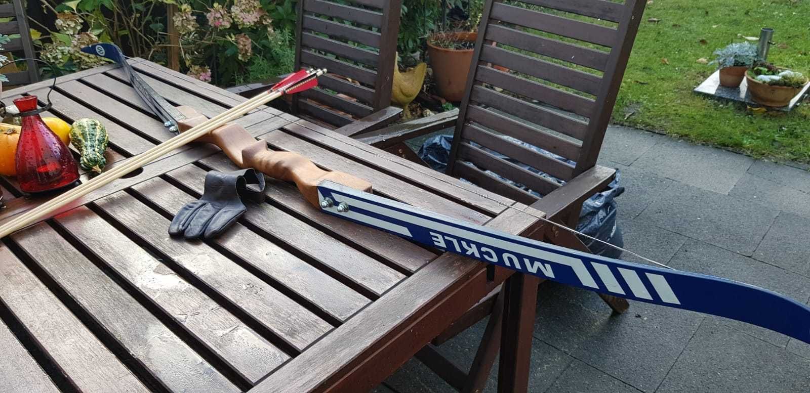

The bow is now fully functional! Yay! To make the bow even more pretty I added some leather on the arrow shelf.

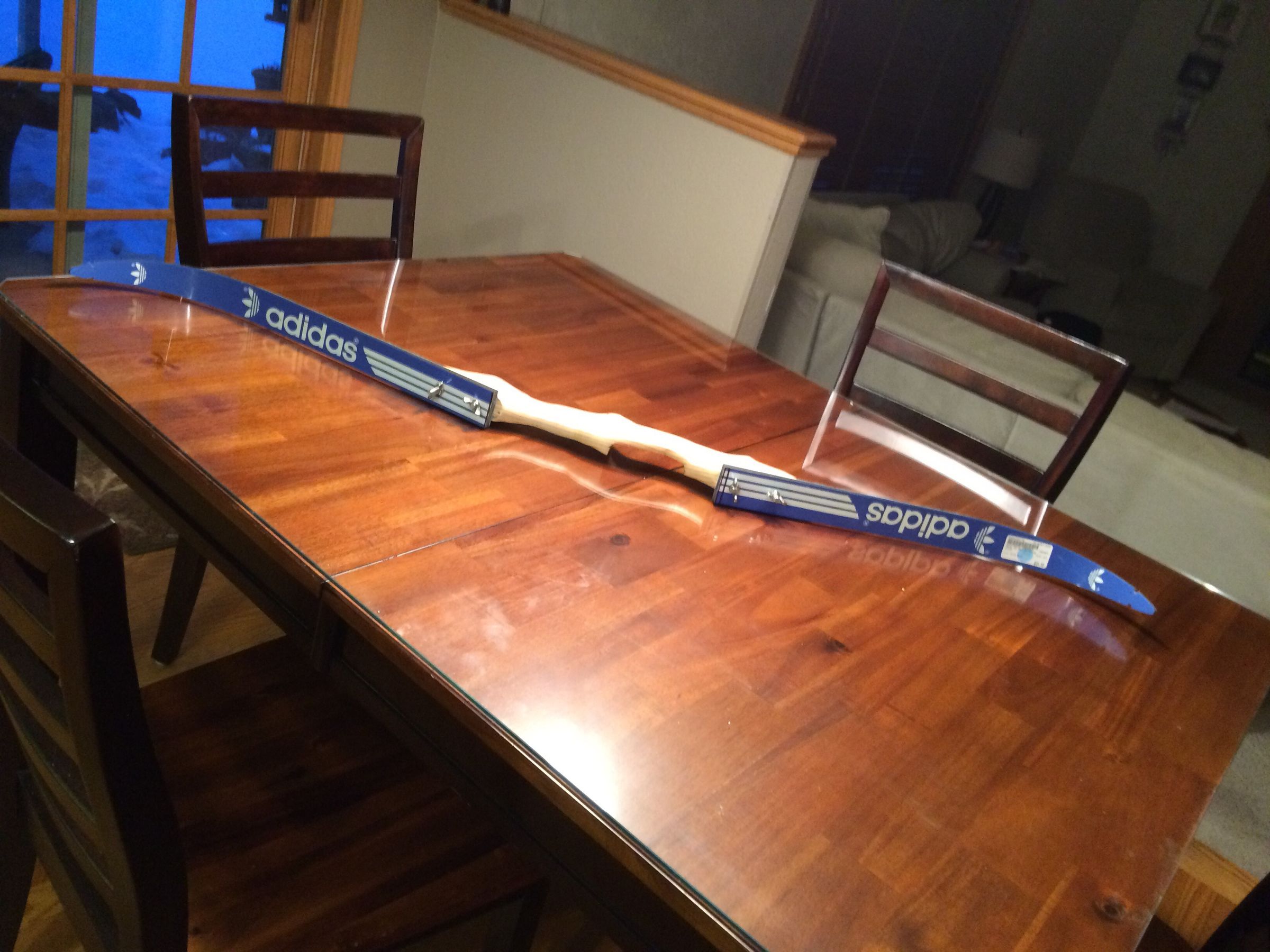

I have tried making several bows in hopes of getting one more than 40#
That’s the strongest I’ve made
With the downhill skis they are quite wide at the top ( hard to put a string around the top)
Do you shape the skis to fit the string or just leave them that width
Also my risers are about 16 to 18 long does the length of the ski matter
The bows usually are about 58-60 inches long
This one pictured is my first one for my wife
28#

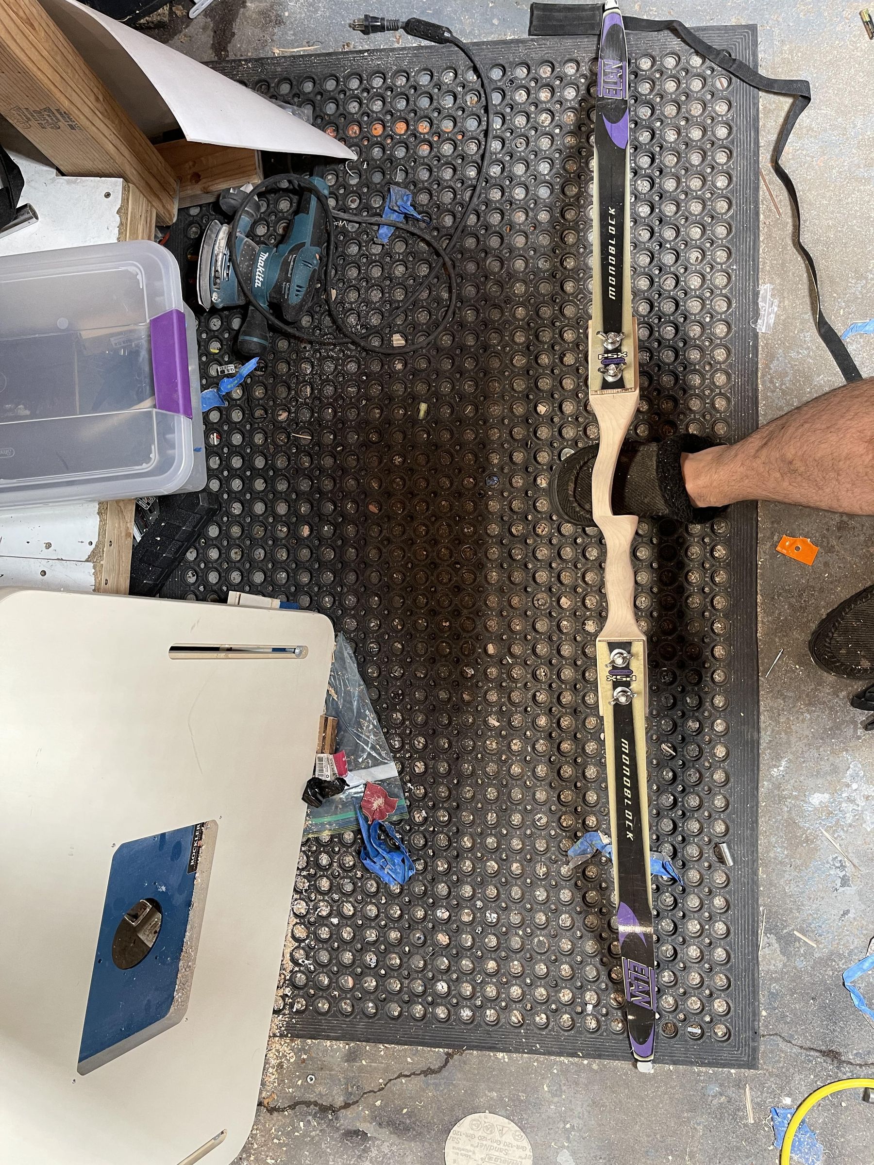

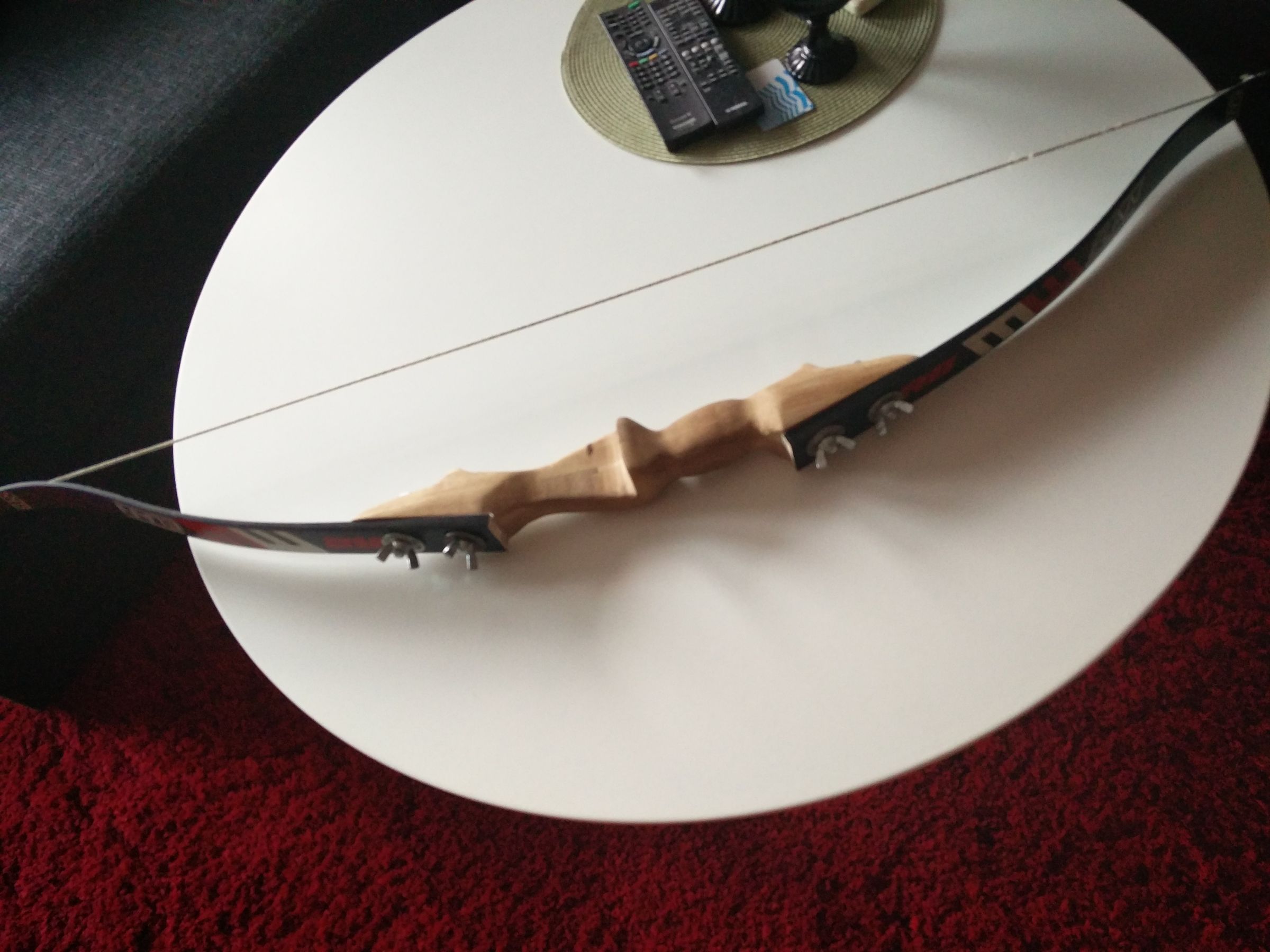

Thanks!! It was a really fun project I actually built the middle from a 2x3
Reply 7 years ago
Recortaste el ancho de los skis ? a que medida ?
Reply 7 years ago
The skis were wider than the wood I did not make them smaller I just left an equal amount of ski hanging off the edge on either side
Los esquís eran más ancha que la madera no hice más pequeños que acaba de dejar una cantidad igual de esquí colgando del borde de cada lado
