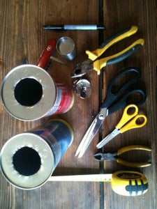

Step One: Select one of your Pringles tubes and set it aside. With the other two, cut a 1.5 inch diameter hole in the dead centre of the metal base (see image). The hole should NOT be big enough for the tennis ball to pass through. The cutting part is tricky, but you should be able to manage with a decent pair of scissors and strong hands. I found the best technique was to mark out the circle on the base and punch a hole in the centre of it. Get the scissors started from this hole and 'wind out' in a spiral until your spiral joins the circle. It's the only way to get the angle of attack right.
Two things worth noting here. While cutting you will occasionally make that hideous nails-across-a-blackboard noise. This is unavoidable, so you'll just have to man (or woman) up. Second, you should file the edges of the hole smooth so you don't accidentally lacerate yourself or your kids on the jaggedy edges. Plus, it will ensure the mortar fires better.
