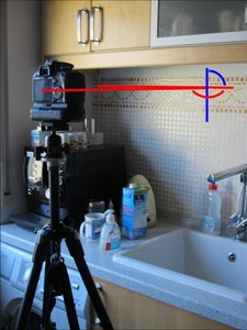

- Set up your camera roughly so that the axis of the camera lens is perpendicular to the tile you photograph.
- To do so, set the height of the tripod according to the horizontal center of the tile. Ensure that the camera is neither tilted horizontally or vertically. You can use a spirit level (if included in your tripod or if attached to your cameras hotshoe, some cameras even offer in camera spirit levels), or by eye balling.
- Properly align the grid-lines of the live display on the camera display with the joints between the tile works. Most cameras offer grid-lines, refer to your cameras manual on how to activate them.
- If the tile works joints (horizontally and vertically) are parallel to the grid-lines on the camera, you should be good to go.
- Take a picture and decide if the sharpness and color rendition is approximately matching the original tile color.

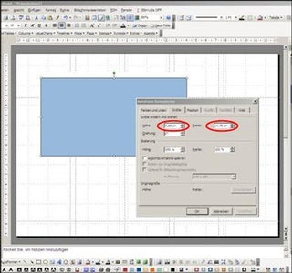

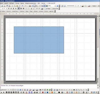

- Draw a rectangle in PowerPoint.
- Right click the rectangle and select the tab which allows adjusting width and height of your selected object (in PowerPoint, this will be the 2nd tab) and enter the height and length you need for your tile (these are the uppermost boxes of the 2nd tab), click ok to apply the adjustment.

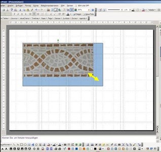

- Import / insert the picture into PowerPoint.

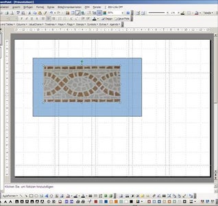

- Crop the picture so that it only shows a single tile without the adjacent joints (if you haven’t done so yet in post processing).
- Position the picture in the upper left corner of the rectangle.
- Pull the picture at the lower right corner until the size of your tile’s picture matches the outline of the rectangle. If you use PowerPoint, it may be necessary that you deactivate the snap to grid feature for proper alignment. If you have to deactivate this function, right click anywhere in your Powerpoint screen and select the grid and guides option. Untick the snap to grid part in the upcoming pop up menu.

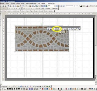

- To ensure you get the correct brightness and contrast level to match your real tile on the wall, duplicate your PowerPoint slide multiple times.
- Use the brightness and contrast UP / DOWN buttons (to increase / decrease the values in steps of 10) of the graphics toolbar to increment brightness and contrast of your pictures on the different slides (this is necessary as most print outs won’t match your monitors color rendition unless you use a color calibrated workflow).
