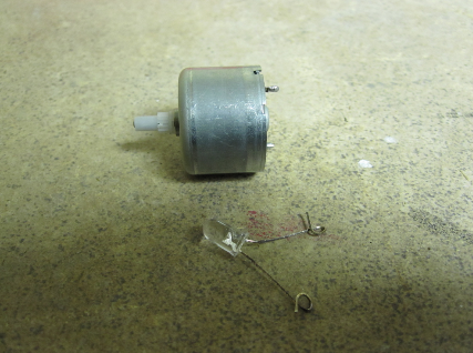

Look in the free bin at yard sales... I was only able to find a tape player motor and a 5mm blue LED.
1. Small Electric motor from a CD player or Tape player. Larger motors will work WAY better, but tiny motors are easier to find in the junk pile.
2. Any LED. 5mm white ones are preferred because of the brightness, but little green or red indicator LEDs will work fine too.
3. It's totaly optional, but pliers would probably help a little.

Step 2: LED Installation
Twist the ends of the LED into little loops and wrap them around the leads on the motor. Give the motor a fast spin and enjoy the free light!
LEDs only work one way (light emitting DIODE), so if it wont light up, switch around the LEDs leads and try again.
