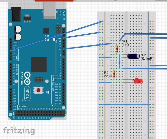

Open the Mega shield file in Ditrace PCB Layout. Place your components on the shield, based on the circuit you designed and prototyped on a breadboard using the Mega board.
Here I added a resistor and an LED as a simple example of how to use the program. The LED is in the "MISC" library, on the top of the screen. The resistor is in the Resistor library. Follow the Diptrace support documents to see how to move, rotate, annotate etc the added components.

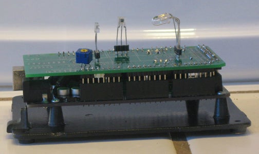

When the PCBs arrive from the manufacturer, you are ready to assemble the board. I start with the male headers, shown in the picture. These are placed on the outer rows of holes in the shield. The short end of the header is attached to the board. The long pins will be inserted into the corresponding sockets on the the Arduino board. Other components are added to either side of the board.
An assembled shield is shown as an example. I placed female sockets on this board so I could test a variety of components prior to soldering them onto the board.

When all of the headers and parts are soldered on, connect the shield to a Mega 2560 R3 board.The example here is a circuit with a three color LED and two light-to-frequency converters (TAOS TSL235 side-looker sensors). The shield is not completely pressed in, to show the pins.
Plug the Arduino board into your computer, upload your code, and (fingers crossed) see how the board works.
