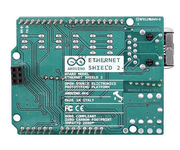

An Ethernet Shield:
US Link: http://amzn.to/2m480iD
UK Link: http://amzn.to/2m480iD

Place the Ethernet shield on top of the Arduino Uno and plug the micro SD card into the card reader on the shield.
Plug the ethernet cable into the ethernet shield and your router.
Finally plug in the Arduino using the USB cable and USB wall cable.
You should now be able to access the server on the IP address you chose.
