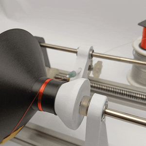

Step 3: Assembly: the Guide/tensioner
The first part we will be assembling is our wire guide and tensioner, an adjustable tensioner is important as it is the secret no nice even windings.
For this step you will need:
- "Guide.stl" and "Tension Knob.stl" printed parts
- LM6UU linear bearing
- 2x 2.5mm heat inserts + 2x 15mm screws
- 4mm heat insert + 1x 40mm screw
- 15mm piece of 4mm I.D. teflon or brass tubing
- T8 nut
- M4 30mm washer
- A soft spring
- Thin felt sheet
First I glued the 40mm M4 screw into the tension knob using the some clear 2-part epoxy glue.
Now using a soldering iron I melted my heat inserts into place, the M4 one goes in the middle of the circular indent (on the back flat side) and two 2.5mm ones go in where the T8 nut gets fastened to.
With the threaded inserts in place we can press in the LM6UU bearing into place, note that it does protrude about 2mm on each side of the printed part.
Now the reason the M4 heat insert had to go on the back flat side is because we will now need to insert the piece of 4mm I.D. pipe into the hole on the opposite side until we hit the heat insert, because I used a brass pipe I could use my soldering iron to insert it the same way as you would the heat insert.
This piece of pipe is just to prevent your enamelled wire from scratching whilst moving through the tensioner.
The final part of the of the tensioner is to cut out two 30mm felt circles (hopefully better than me!) with 4mm holes and then glue one to the printed tensioner and the other gets glued to the washer.
The "washer" I'm using is actually the centre of an old floppy disk, because it has the lifted edge it makes it easier to insert the copper wire into the tensioner.
Your guide and tensioner are now ready.

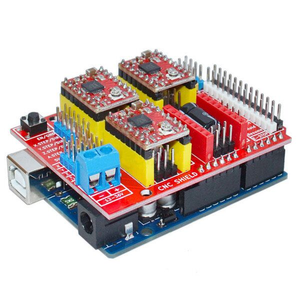

Step 5: Assembly: the Electronics
In this first iteration of the coil winder the electronics are as simple as can come.
We are simply making use of off the shelf boards namely the CNC shield V3 with two DRV8825 or A4988 stepper drivers all driven by an Arduino Uno board.
To get it going you will only need to mount the CNC shield onto the Arduino Uno, insert the two stepper driver boards onto the X and Y slots and then plug in the wires from the stepper motors to their corresponding pins next to each driver.
To run everything you will need to upload the GRBL sketch to the Arduino Uno.
- The latest version of GRBL can be downloaded on Github

To enable support for different shapes and sizes of bobbins I made a simple cross shaped male coupler on both the winding motor (5mm) and the bobbin support (6mm), this way you can make custom holders that suit your specific needs and then simply slide the female holder onto the coupler.
Because of the future project that will consist of 3D printed speaker driver this method allowed me to print a holder that will support a large awkwardly shaped bobbin that is quite delicate to boot in place to wind the coil.
After multiple binding issues I ended up printing these self centering couplers by Loco on Thingiverse and they really work fantastically!
Finally we need to extend the reach of the tensioner to the bobbin, I designed the tensioner to accept a 4mm PTFE tube (3D printing bowden tube) so that you can have a few different lengths pre-cut that can be switched between.
The PTFE tube is also the same size as a syringe needle, I cut a needle slightly shorter then heated up the tip and just flared it ever so slightly with a nail just to get rid of burrs that might damage the enamel coil wire.
