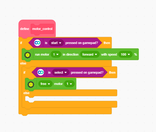

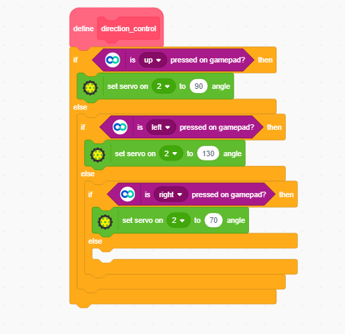

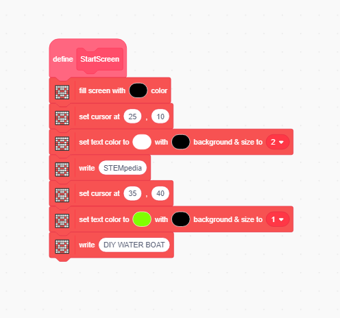

Step 6: Code
Script the following code in PictoBlox and upload it to evive.

  • Start key – Start the motor
  • Select – Stop the motor
  • Up key – Move the boat forward
  • Left – Turn Left
  • Right – Turn Right
