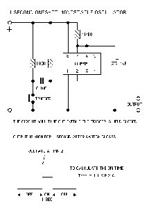

The timer that controls the effects is based on the good old 555 timer chip. I used the low-power CMOS version.
You can adjust the amount of time that the timer stays on by varying the values of the resistor to pin 7, and the capacitor to pin 6.
Time (seconds) = 1.1 x R x C
It is a good idea to set up the circuit on a breadboard to get the bugs worked out prior to soldering. However, in my experience, things can behave differently once they are reassembled onto a circuit board. I had to adjust my component values a little bit once i built the circuit on perf board.

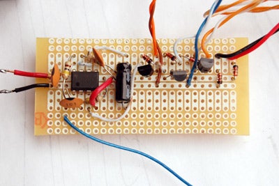

Once i had the one-shot timer working, I rebuilt it on a piece of perf board.
I tried driving both the bright red muzzle flash LEDs and the Laser diode directly from the output pin of the 555 chip, but it didn't seem to work once I added the second effect, so I chained together 3 NPN switching transistors (with diodes to the trigger legs) to use as outputs for the effects. Using the transistors to turn on the effects individually gave much more stable results.
At this point you should set up the LED, laser, and sound module on a breadboard and test to see that they are being triggered properly.

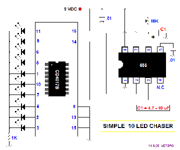

I found this 10 LED chaser circuit on the web, and integrated into my design.
This circuit produces the sequentially flashing line of blue LEDs that shoot down the sides of the blaster when it is fired.
The circuit consists of another 555 chip, this time wired as a straight oscillator. The oscillator output drives the 4017 decade counter chip, which has 10 transistor outputs.
I wired up 2 arrays of 10 LEDs, one for each side of the gun, and hooked them to the appropriate pins on the 4017. I built the chaser effect on a second circuit board because I ran out of space on the first one.
I ran a jumper from the output of the first timer circuit to the LED chaser board where I had installed an NPN transistor to turn on the effect.
The chaser will cycle over and over while the signal is high, so I adjusted rate of the oscillator (variable resistor on pin 6-7 on the 555 chip) so that the chaser would do one full cycle during the time that the effect was in effect.
