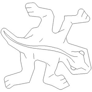

Step 1: Cut Your Reptiles! Paint Them Too.
Using the attached 'lizard-large.dxf' you can cut out your own escher reptiles. I do it in 2 steps:
Open the .DXF file, and you'll see both and outline, and a bunch of internal lines. I do the engraving both on the internal lines, and the outline. I do it with a 90-degree V router bit. After then engraving, you can cut out the reptile with up to a 1/4" diameter router bit. A larger bit won't cut the internal radii right.
Then, I let my kids paint them however they like. Obviously, if you're using really nice wood, you'll want to skip the painting and staining steps... This would look great with 3 types of hardwood, I'm sure. Maybe I'll try that next.
