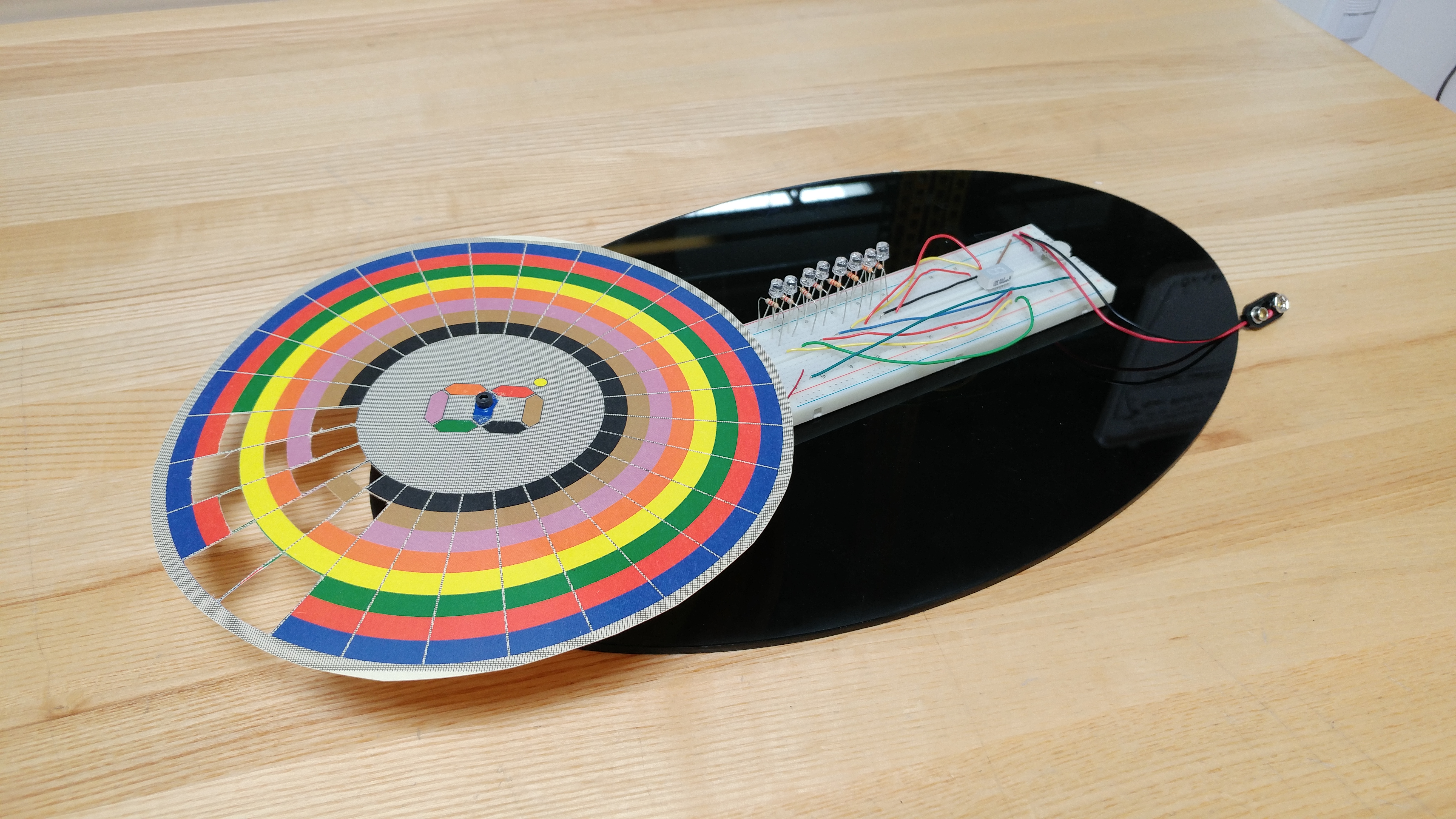

Step 5: Design
So how does all of this relate to our device? We will use cutouts instead of pits to allow light to pass through to sensors beneath the disk. The disk will be like a pizza with 28 slices, each having 8 cutouts. The cutouts in each slice will light up an individual section of the 7-seg. The disk is rotated using a motor so that each slice gets a turn controlling the 7-seg. 8 phototransistor sensors below the disk will sense the light being either blocked or allowed through. If there is a cutout and light is shining through, then current will be allowed to flow through the transistor and will illuminate the section of the 7-seg.
The second picture shows the disk with each color corresponding to a part of the 7-seg. If you cutout every color in one slice then the entire 7-seg will light up for the duration of that slice. If you cutout the purple part of the slice then the top element in the 7-seg will be illuminated. Cutout red and blue and the middle and bottom right section of the 7-seg will light up.

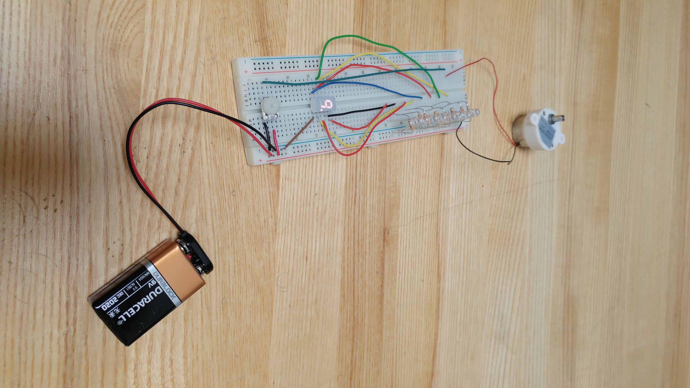

Step 7: Build the Electronics
Now lets build the electronics:

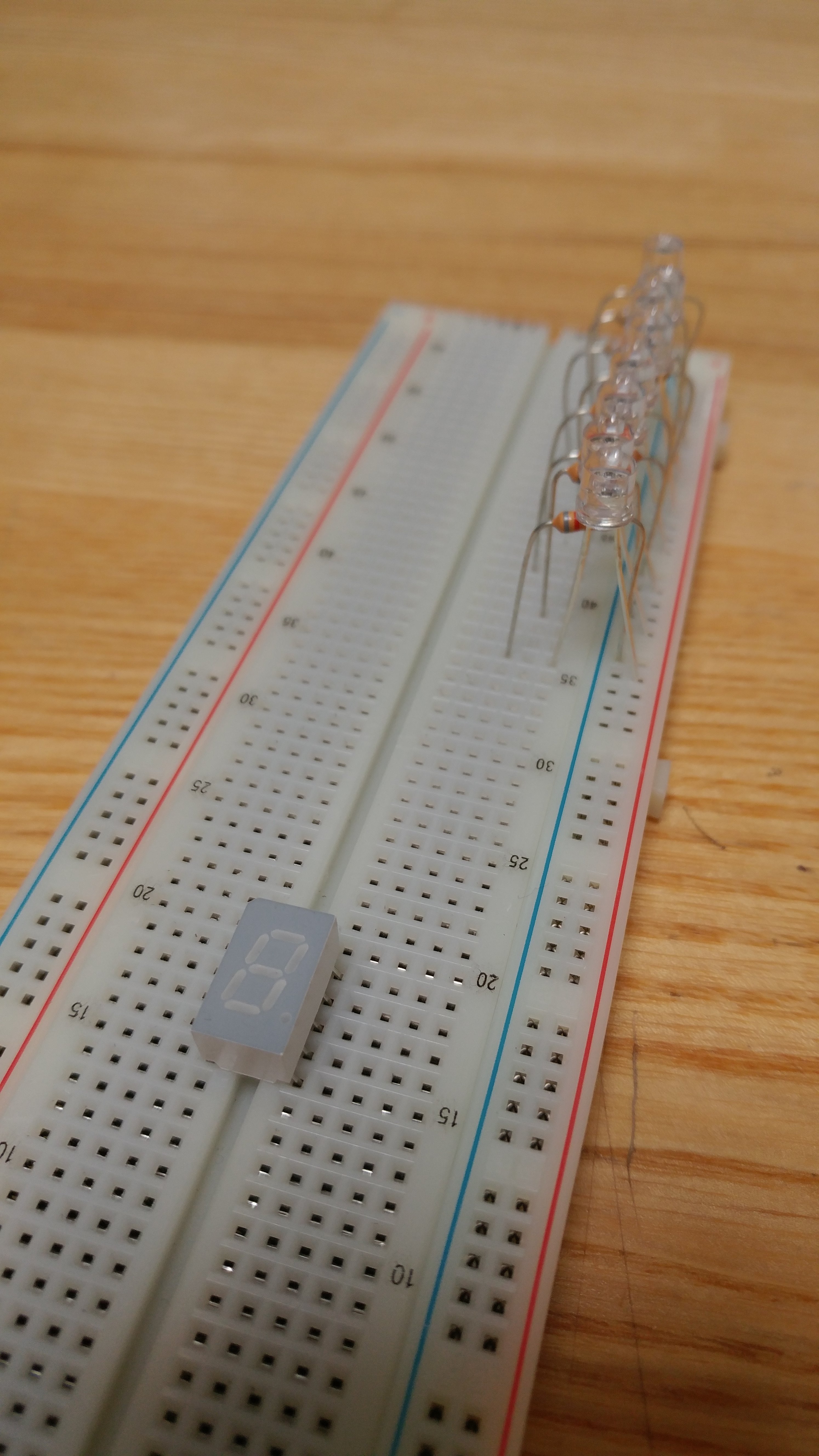

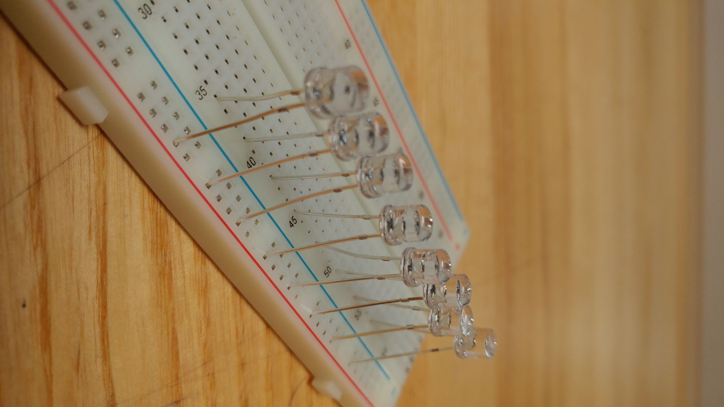

Plug in the phototransistors. The long lead should go into the positive rail. The short end should go into column 57, row a, b, c, d, or e. Put the next phototransistor 3 spots down, there should be two columns in-between every phototransistor.

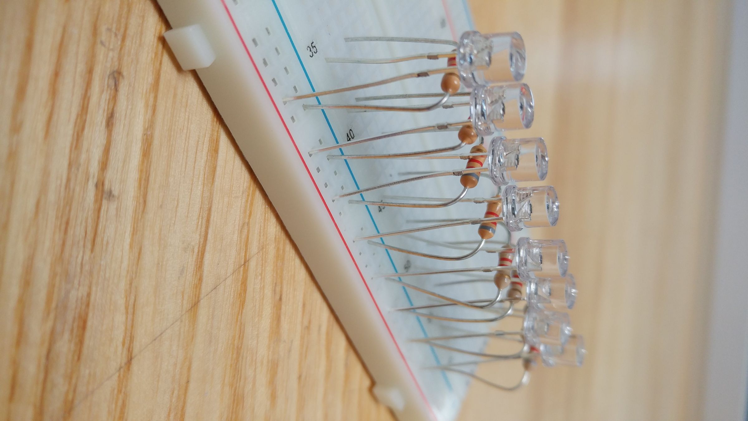

Plug in the 8.2K resistors. One end should go in the same column as the short lead of the phototransistor. The other end should go into the ground rail. Make sure the leads of the resistors don't short anything!

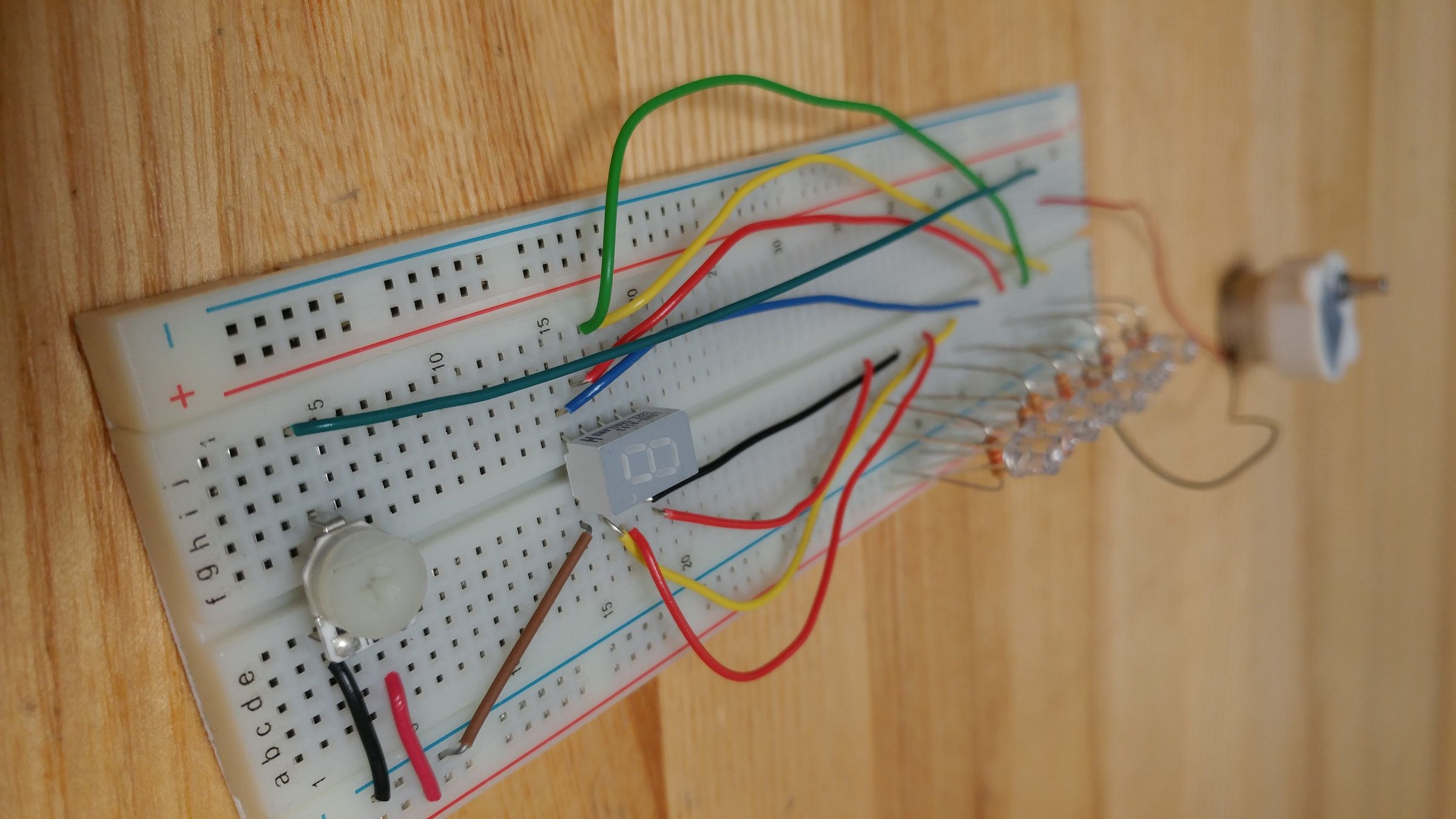

Plug in the 7-seg display further down the breadboard.

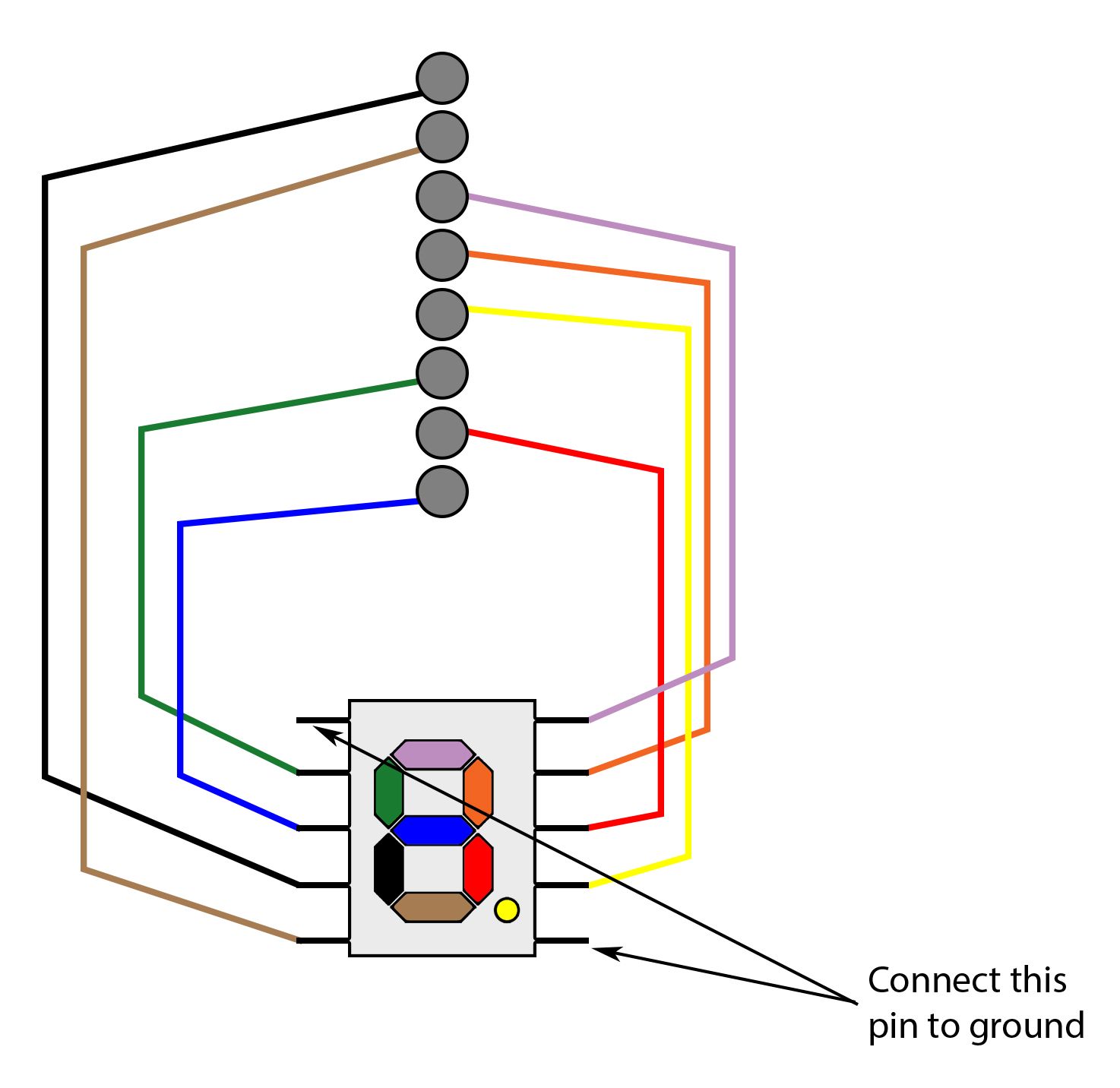

Connect the phototransistors to the 7-seg using the following picture as a guide
Plug in the potentiometer below the 7-seg. Connect one lead to the ground rail and one to the positive rail (9V in this case). Then connect the motor's negative wire to ground. Connect the positive wire to the potentiometer's wiper pin of the potentiometer (this is often the middle pin but check the datasheet).
Plug in the 9V and you are done!
If none of the 7-seg lights up then you want to unplug the battery as there is probably a short.
If some parts of the 7-seg are not lighting up then the corresponding phototransistor might be broken or be plugged in wrong.
Here is a demo model I made for the electronics:

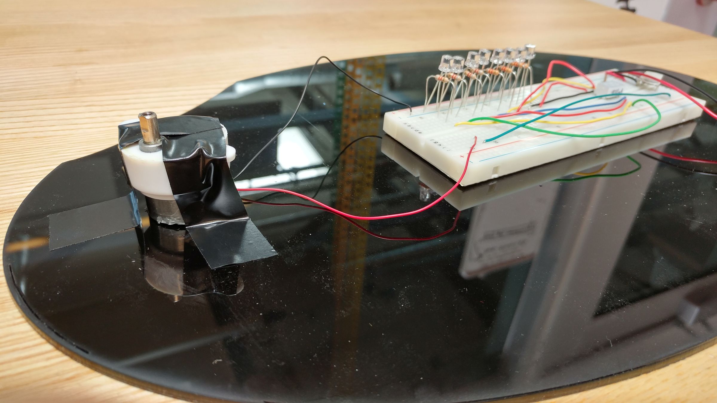

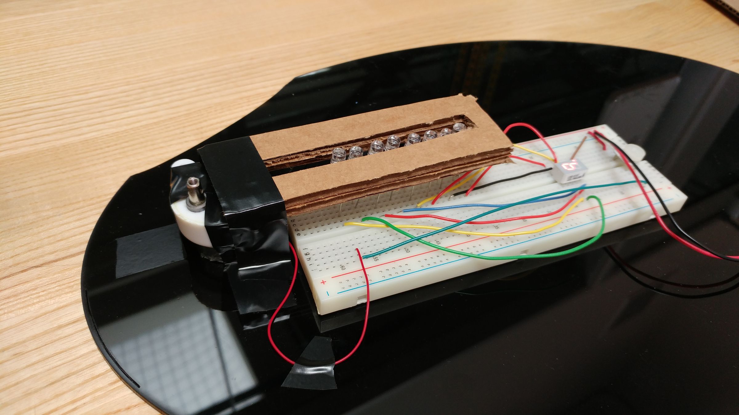

Take your electronics and place it on the base of your choice. I used an acrylic sheet that I had lying around. Then tape the motor to this surface.

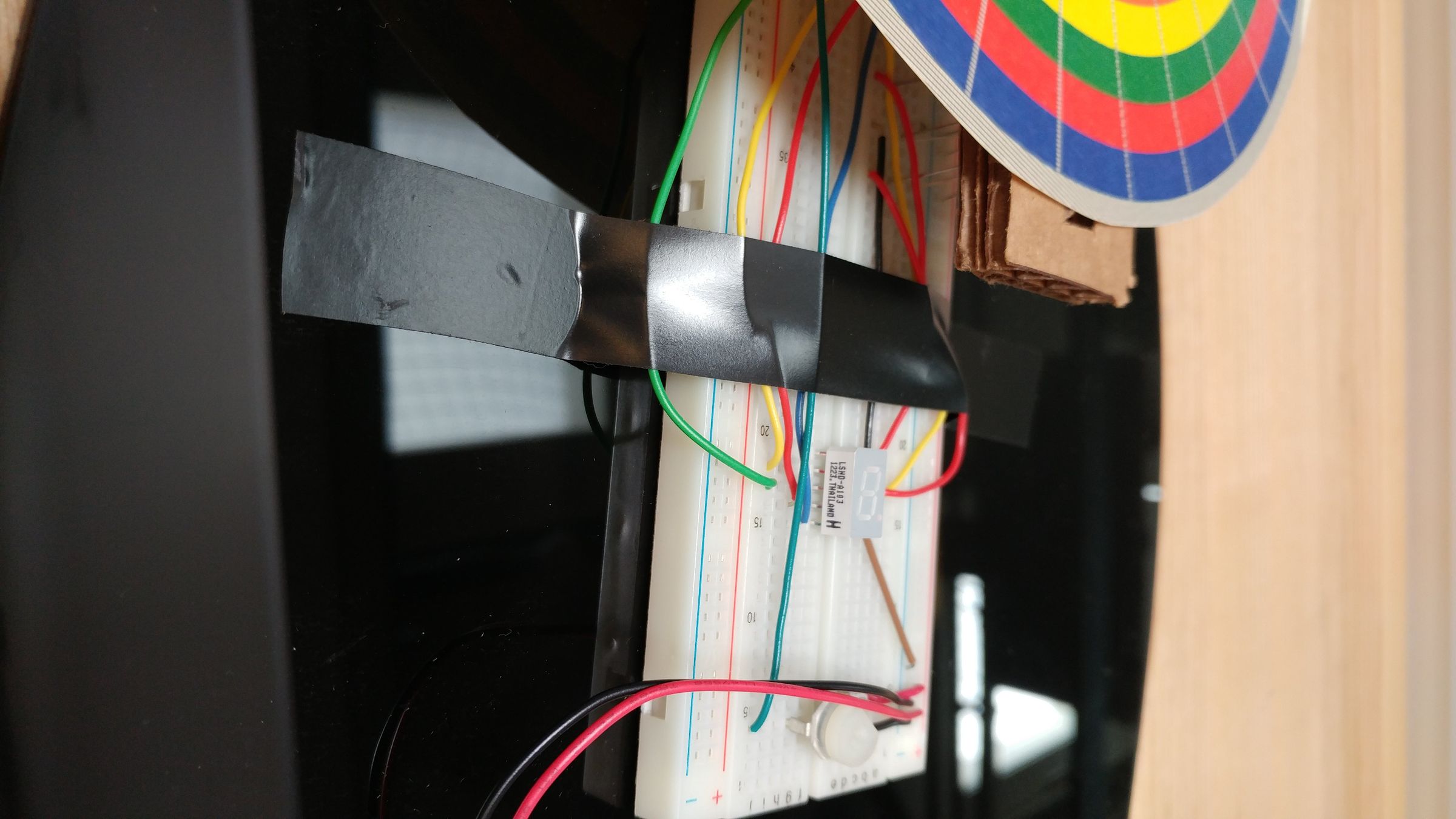

Then print out the attached picture of the disk. Cutout the circle part and punch a small hole in the center of the disk. Put the disk on the motor and secure it with the bolt. The bolt goes through the paper and screws into the motor shaft.
Next you want to put the breadboard and phototransistor array underneath the disk such that the phototransistors line up with the lines/rows of the disk. Once you get them lined up, secure the breadboard to the base.

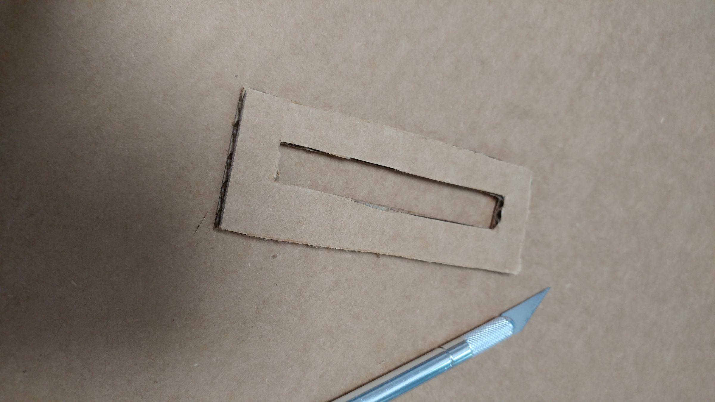

Now we want to add some shielding to the phototransistors. This keeps stray light from bouncing into the sensor and lighting up the 7-seg accidentally.
To do this cutout a rectangular piece of cardboard with an intern cutout that is about the size of the phototransistor array. You might need two of these.
Tape one or two of these onto the motor such that it aligns with (and protects) the phototransistors.

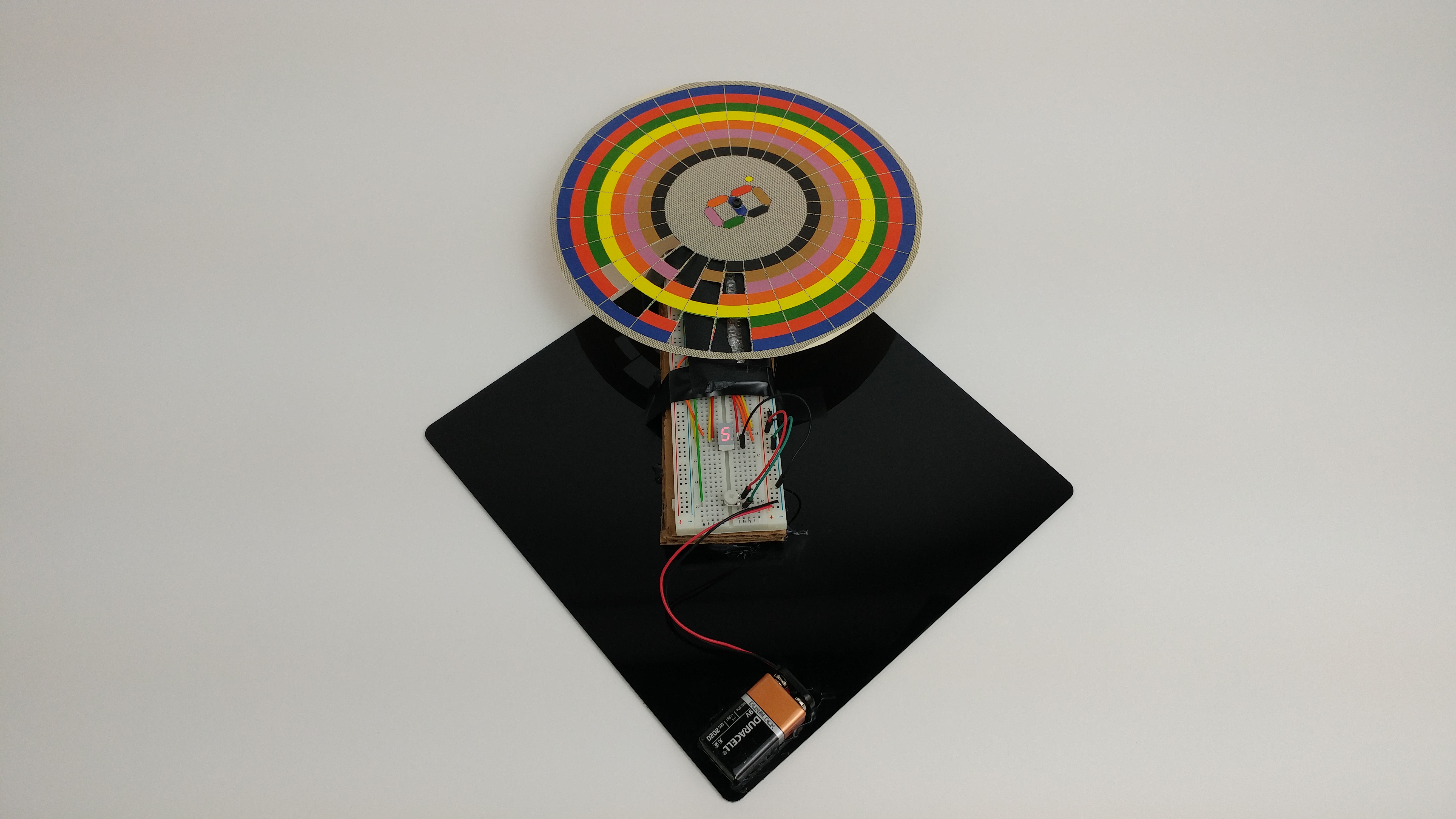

Lastly, screw the disk back onto the motor and you are done!
This is an example of the finished product I made:
