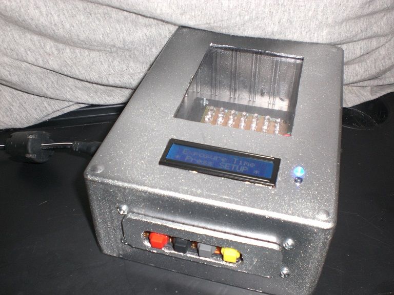

The finished gift will have Eagle CAD custom PCB's for the power supply and logic, housed in a plexiglass enclosure.  The entire theme is ice blue LED lighting to simulate an analog clock.  While the enclosure has a white on blue LCD displaying the day, time, and room temperature, a serial cable connects from the project box to the actual clock.  Using a 12 bit decade counter, a servo, and lots of blue LED's I am lighting the appropriate hour segments on a custom-designed analog clock face printed on plexiglass.  The servo is mounted in the center of the clock face and has an armature attached with an LED mounted to light up the minutes behind the glass.  (each minute the servo turns 6 degrees, lighting up the appropriate minute).  I hope to have it finished soon and will make a video of the final product....I hope she loves it !!
