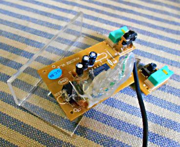

Step 8: Hack a Mouse and Make the Mouse Cover
I have used the Toshiba U10 mouse to make this prototype.
Open the casing of the mouse, and remove the scroll roller.
Now, you should have space to place the pen like in the picture.
We need to prepare a case for your mouse circuit to be housed. Take dimensions of your mouse circuit and lasercut the pieces accordingly.
Now, there should be a plastic lens with a small prism, apply hot glue to it and stick it to the mouse board at it's initial position.
To make the housing, I had designed the cover as shown in the images, and laser cut it.
To make the USB cord connections to the mouse circuit stronger, I have applied hot glue to the wires.
