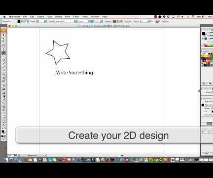

Step 2: This Is a Video Tutorial for the Whole Thing....

In my example I chose not to turn the bitmap text into a vector, but instead to just redo it in Illustrator. This was because it is easier to get crisp text that way, and when I tried to do the text AND the image I had to use two different tolerances for them both to look smooth.
However, remember to "create outlines" any text you create in Illustrator. That way when you send your file to your CNC machine/driver it will work correctly even if the driver doesn't have the font you had on your computer.
