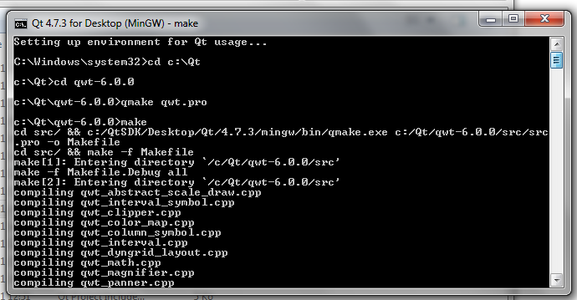

Here comes the tricky part. The files you downloaded are not compiled.
So you must compiled them. To do so you must start the Qt prompt console.
You can find it on Windows in :
start menu,
Qt SDK,
Desktop,
Qt 4.7.3 for Desktop (MinGW)
Then send the command that are on picture 2.
Congratulation, you perfectly compiled the library!

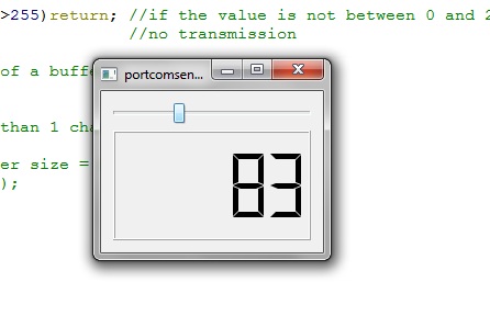

Now you have installed all the library you need (qwt and qextserialport) your are ready to program.
I join a little example of a program (see the video in the introduction) which show data send from an arduino. In the next step I give a little program for your arduino to play with this progrme. If you want to do more complicated graphs you can have a look to the folder "examples" of the qwt lib.
All the description are into the program.
If when compiling you have the error n°1073741515 (or maybe another) that mean that you need to put the qextserialportd.dll into your .exe folder. Don't forget to also add the qwt.dll.

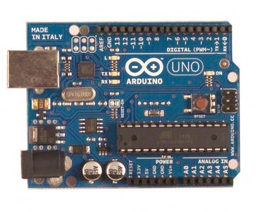

Step 3: Program Your Arduino
Here is the program to send data.
It send only random data, up to you to improve it and add real probes.
