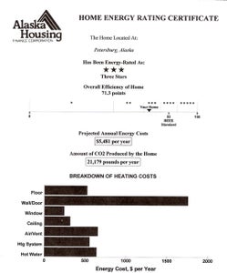

I have taken advantage of two different programs for two different houses in the last 9 years. The first we put insulation in the floor and attic and sealed gaps and earned a lower interest rate on the loan. The interest rate reduction was significant enough that within three years the interest rate alone made up for the cost of the materials (we did the work ourselves). The improved energy savings probably bumped the break even point to just one year.
Recently, I qualified for up to $5,500 in reimbursement for my current home. The recommendations primarily included adding insulation to the attic and the crawlspace. I paid a few friends $10 an hour to help me get the work done but that expense was not reimbursable. (Strange that if i had contracted the work out entirely those costs would be reimbursable - paying some friends a few hundred dollars probably saved the state thousands.) But with the saved expenses i'm able to make even more improvements to the house that will save me money over the long run.

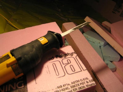

I found that a reciprocating saw with a long blade worked well for cutting the sheets. It did leave foam sawdust everywhere though!

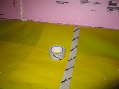

Hot air rises. And as it does it draws in cooler air to replace the air that has risen. Think of the house as a big chimney. Where does that air come from? A good portion of it comes from below the house. Even when cooling a house, hot humid air from below is introduced to the living space.
An important method of improving air quality in the home is to add a vapor barrier. This step is not likely to be covered in energy efficiency programs but it makes sense to take it on while you're under the house and improving the value of your property.

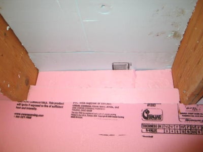

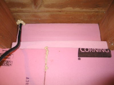

If you use rigid insulation, along two of the walls you will have to butt the foam boards up to the floor joists. You will need to fill between the joists with fiberglass batts or with pieces of rigid insulation friction fit into the openings. Be sure to seal any openings or gaps around the blocking.
