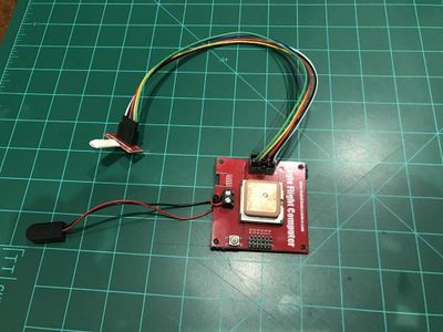

- Flight computer (optional) - I like knowing how high, how fast and how cold it was during my launches so I use the eagle flight computer from highaltitudescience.com. It's a beast and very accurate and reliable.

The first card I pull is the Eagle Flight Computer SD. I load it to see how long, how high and how fast. It's printed in a text format so you have to translate the data a bit but it's not difficult.
