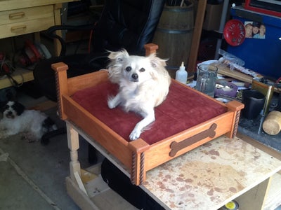

In this instructable, I will show you an easy to make canopy pet bed or infant photographers prop. My Sister-in-Law requested a canopy bed for infants. An image search turned up several designs. Most of which were made with pre-spun staircase balusters. The spindles right off the home store shelf, are made from poplar. Poplar isn't the prettiest wood, but it is a hardwood that mills nicely and accepts stain.

I made the headboard and foot-board first by gluing and pocket screwing the posts to the boards.I used scrap blocks to locate the distance from the bottom of the post and the bottom of the frame. This distance is 1.5" I also place a piece of 1/4" plywood under the frame boards while gluing and screwing it together. This will automatically properly locate the frame boards to the posts for you simply by holding it in place while you pocket screw it together.

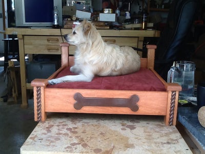

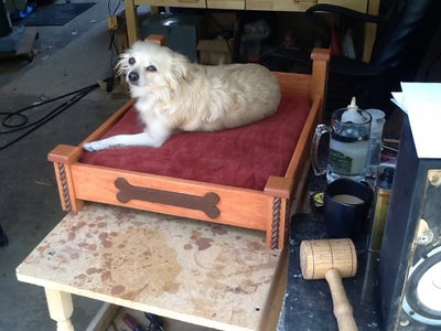

Your bed is finished and with proper care it could easily last a lifetime! Hows that for a cheap but MUCH better alternative to a store bought bed!
