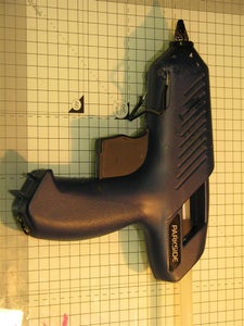

I occasionally make radio control model planes out of Depron foam and EPP sheets (foamies) and these materials have quite a low melting point. At its normal temperature, hot glue will spread across the surface of the foam and eat into it causing bubbles of gas to blow into the glue and making a very messy joint. The same is true of fanfold foam and Styrofoam (expanded polystyrene) which is much the same thing and melts into nothing at full heat.
Look at the photo. At its normal temperature my gluegun makes a mess of the foam. Turning down the heat reduces the bubbling until the glue is below the foam's melting point, which still gives a solid join much stronger than the foam, but so much neater. With my modified glue-gun I can now make repeatable neat joints in the foam with no distortion due to overheating.

Calibrate the gun with a piece of scrap foam. Set the dimmer to half way and wait for a few minutes for the temperature to stabilise. Rest the gun nozzle on the foam and if it fizzes and sinks through, turn the dimmer down a bit, wait and repeat.
The optimum temperature will be the point where the nozzle just marks the foam surface. Mark this on the dimmer dial.
Depron and EPP have about the same melting point so can use the same setting, but if you're working with other materials you may want to calibrate for these as well. I find about 1/3 setting gives the best results for the foams I use.
