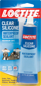

Step 4: the Adhesives You Can Use.
Use fast drying clear araldite adhesive, or any other fast drying waterproof adhesive:-
If you choose to use Araldite then you need to mix equal amounts of
the adhesive from both the tubes together, and then use.
The drying time is about 5 minutes for the initial bond. But let it dry for an hour or two. Cost=Rs.40.
You can also use a silicone based adhesive or plain and simple Super Glue to do the job.

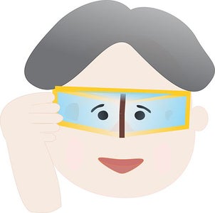

…Hold the prism filled with Water or Glycerin oil in front of your eyes, close to your face as shown in the illustration above.
You may hold it with either the flat side facing you, or the angled side towards you...it doesn't matter.
Hold it as you would hold a binocular...close to your face.
The images which appear as two images on the monitor will turn into three images when you hold the prism in front of your eyes. The image in the center will be the 3D image.
My monitor is a 26 inch LCD and I get a comfortable 3D view, sitting approximately 2.5 feet(30inches) to 3.5 feet (40inches) away from the monitor.
