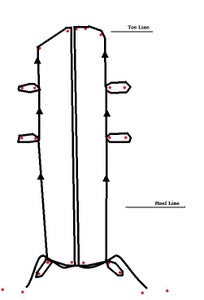

Step 3: Make the Loom!
In order to make the sandal, you need to make a loom for it. This is done by hammering the nails in at specific points to give a framework to weave around. The nails will form the base for the sisal rope which defines the shape of the sandal.
The shinigami sandals have six loops as opposed to the traditional four. Mark out where on the board the end of the sandal will be, making sure it can wrap up around your heel! You can guess this, or take a run of string from the end of your toes and curl it up around your heel to where you want the sandal to end and use that measurement instead.
Once you have the markings in place, pound in the nails where indicated. 10d finishing nails will give you about two and a half inches above the board to work with. A few nails at the bottom are used to hold the rope taut.
On previous versions of the sandal the loom was symmetrical, but since this version extends to the end of the toes like a traditional sandal it has a shape like one, jutting forward a bit more where the big toe is.
At the far back of the board, hammer in a few nails to give you something to wrap the free ends of the rope around. The next step will show how this all makes sense.

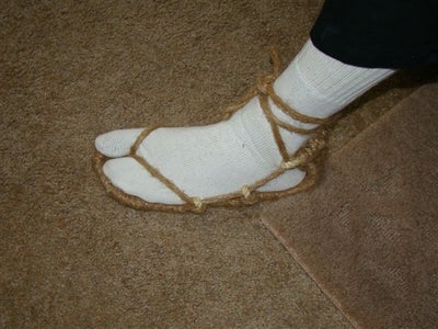

Finally, you can now add the sandal thongs to each sandal, turning each one into a left and a right.
Down the middle of each sandal on the inside, you'll have the two thicker ropes. To add a sandal thong, the trick is to separate the twine in that area enough to expose one of the thicker ropes, and then thread the rope for the thong through the sandal making sure it wraps around this rope. It sounds more complicated than it really is. In order to open the weaving far enough to do this, stick your scissors through the sandal and open them, using the leverage top pry open the weaving.
You'll now have a left and a right sandal.
The thong rope itself can either be the sisal rope or the jute for this. I used a double length of the Jute twine I wove the sandal out of to make the thongs.
Each thong string should be about six feet long so you can cut off the excess once you wear the sandal. Thread the thong strings through the loops in the side and heel of the sandals.

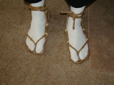

Step 9: Wear the Sandal and Trim the Ropes!
Place the sandal on your foot and pull on the thong ropes. They will go taut over your foot, pull up through the loops, and pull the back of the sandal up around the heel. Wrap the ropes around your ankles two or three times until they are secure and tie them off, then cut off the excess.
For added cushioning, I recommend sliding the Dr Sholl's insert into your actual sock.
Congrats, and enjoy your new sandals! These will last for several days of heavy use if you wove them right. I've included a few pics of mine that were finished!
