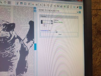

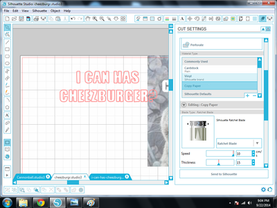

On the top right is the "send to silhouette" icon
Your computer will attempt to connect to the silhouette cutter, if the cutter is not on it will not connect

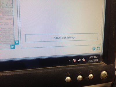

You can still adjust cut settings whether or not the cutter is connected

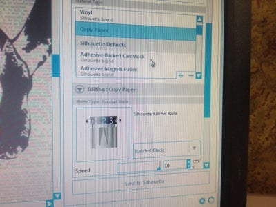

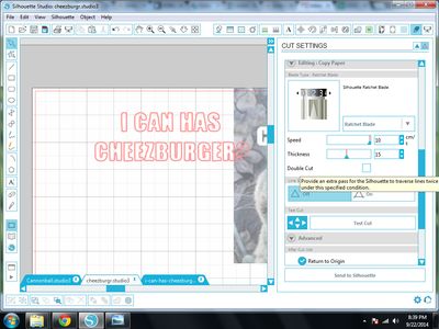

Chose your media - paper, vinyl, construction paper, all require a different blade depth and default cut speed.
DO NOT START WITH YOUR WORKPIECE - INSTEAD always do test cuts first
paper is a nice cheap way to see how large your project is, and determine whether you need to change the scale of the design to allow for unbroken lines, the thinner a segment is, the more likely it will accidentally tear or fail structurally in some way. This is also a chance to confirm your design actually works as a stencil or if you missed a section when choosing your layout. You might have the wrong piece floating instead of connected to the core structure of the sticker/stencil.

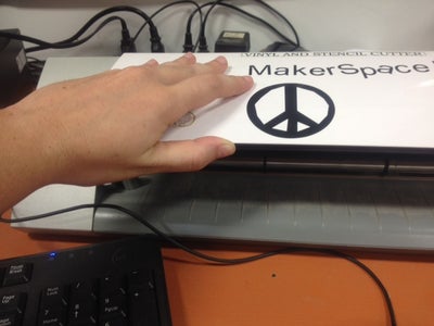

So let's open it up and turn the cutter on!
You'll find the pieces you need on the far left usually

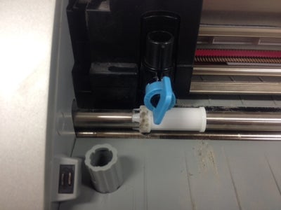

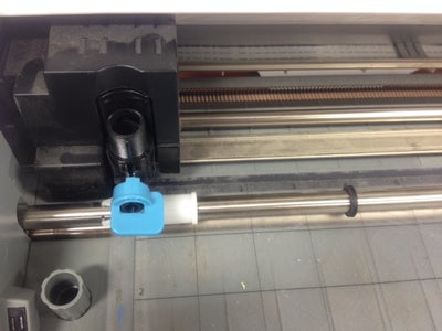

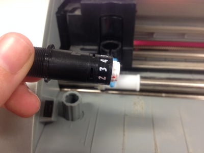

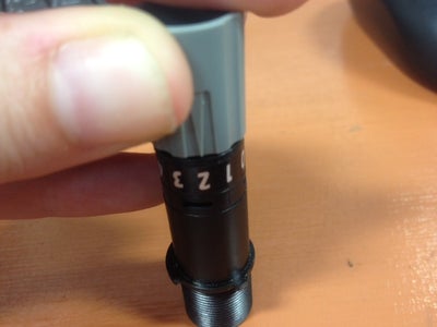

The ratchet blade has different settings for depth, and will need to be removed and adjusted to your corresponding media
For paper the blade needs to be set at 2 (in this case)

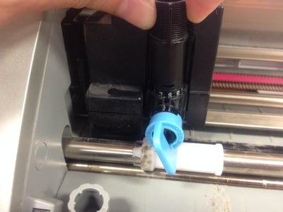

The small black handle to the blade can be removed after counter clockwise turning the blue locking mechanism to free it. The blade is sitting in a spring loaded mechanism, so it moves freely up and and down the vertical axis, but it is locked in place in the horizontal axis.
BE CAREFUL to not cut yourself on the tiny exposed blade. It's small but fierce.

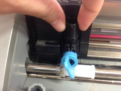

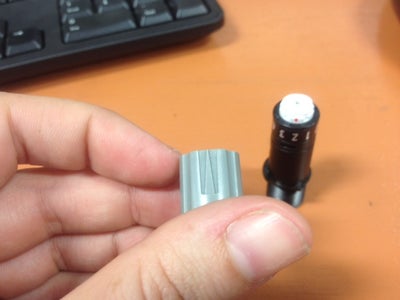

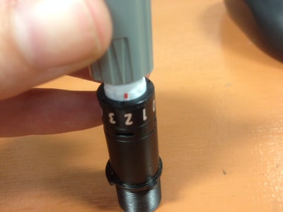

Line up the key's arrow with the red dash and twist with slight pressure until the arrow (and the dash under it) line up with the number your blade needs to be at
Replace the blade, placing the ridged side nearest to you and the blue locking mechanism, the ridge of the black handle should slip into a small vertical slot, and you can turn the blue lock clockwise until it is secure. I've found it's hard to break this lock, so experiment until you've found the right spot. Again, the blade is sitting in a spring loaded mechanism, so it moves freely up and and down the vertical axis, you are locking it in the horizontal axis to keep it from spinning or slipping.

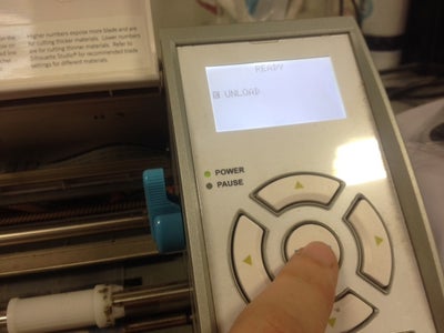

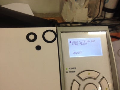

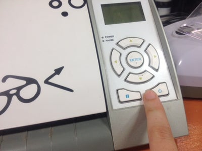

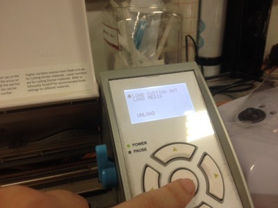

Load your mat by placing it along the left edge with the arrow pointing inwards, and gently pressing against the "wheel" edge on the upper side. When you press the center key to select "load the mat" the wheel will turn and bring the mat into the machine a few inches.
A great way to confirm you've loaded everything correctly is to check that the blade is centered on the top left corner of the working area (location 0x0 on the grid lines of the mat). Select unload and adjust how you set it up to load until you've got it right.

Step 17: Send to Silhouette! Test Cut!
Think you're ready? Double checked settings and scale? everything loaded? LET'S DO THIS
Note: the blade was not locked in place during this cut, and may have caused some errors. ALWAYS CHECK YOU'VE LOCKED YOUR BLADE IN PLACE
Step 18: How'd It Go With the Test Cuts on Paper?
Paper is fragile! most of these tiny extra folds shouldn't happen on the vinyl, but we may want to scale up just in case. Using a tool really helps with peeling up the unwanted pieces, especially if you want the stencil and the silhouette of your workpiece.
The paper wasn't fully cut though! So we'll double the check blade height, media setting was correct etc... but what really makes a huge difference is selecting DOUBLE CUT in cut settings

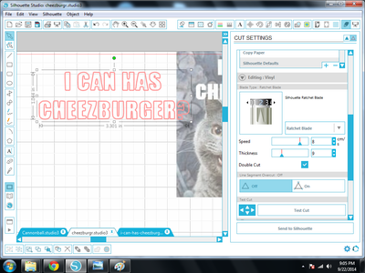

The blade will make every cut twice before moving on to the next one, and stops minor imperfections interrupting the cuts, and helps ensure whole cuts and no particle cuts.
Step 19: Switching to Vinyl
swap the settings
check the blade height
be sure to check the box for "double cut"
blade is locked in place?
LET'S DO THIS
