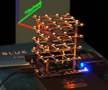

Step 1: How Does It Work?
The Cube:Bit is constructed from layers of PCBs which have RGB pixels made from addressable LEDs on the top and the bottom as well as electrical contacts on the inside of the four corners. The WS2812 protocol use a single data pin with the pixels arranged electrically in a long line forming a shift register - the output from the previous pixel connects to the input of the next. Each layer has GND and 5V pads to power the pixels and DIN and DOUT pads to connect them to other layers and the base board.
The 5V power source is selected via jumpers with a choice of:
- 2.1mm barrel jack (centre-positive),
- micro-B USB,
- three male header pins,
- 3 pads with 4mm banana plug holes labelled for the 4tronix Crumble.
As a guide to the power required which can be considerable, 4tronix documents the Cube:bit's typical current requirements as:

Step 3: Coordinate System
This small program displays the coordinate system for the Cube:Bit. The x, y and z dimensions are shown on the Cube:Bit illuminated with red, green and blue, respectively. The the line drawing starts at the origin (bottom left near the viewer). In MakeCode these are numbered starting from 0. The coordinates for the pixel next to the base's CUBE:BIT logo (near the micro:bit and viewer) is (3,0,0).
This works on V1 and V2 micro:bits.
