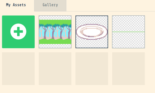

Step 1: Assets
Both the plate and the background are available in the 'gallery' so you don't have to draw them yourself. 'Check' is a 160x1 sprite at the bottom of the screen. It will be used to detect items touching the bottom of the screen.

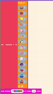

fallist - list of the images of falling things.

First, you print the instructions. Then you set starting values (hp, score, locations) and create the player and the check sprite. The player sprite should be somewhere at the bottom and the check sprite at the very bottom. Then you set the images of the falling objects in the 'fallist'. The food should be at the beginning and the other things should be at the end. Remember how many food sprites are on the list, because we will need them later. And lastly, We play a sound indicating the start of the game.

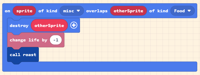

Step 8: Collisions: Check - Food
Destroy the food, decrease the hp and roast the player.
