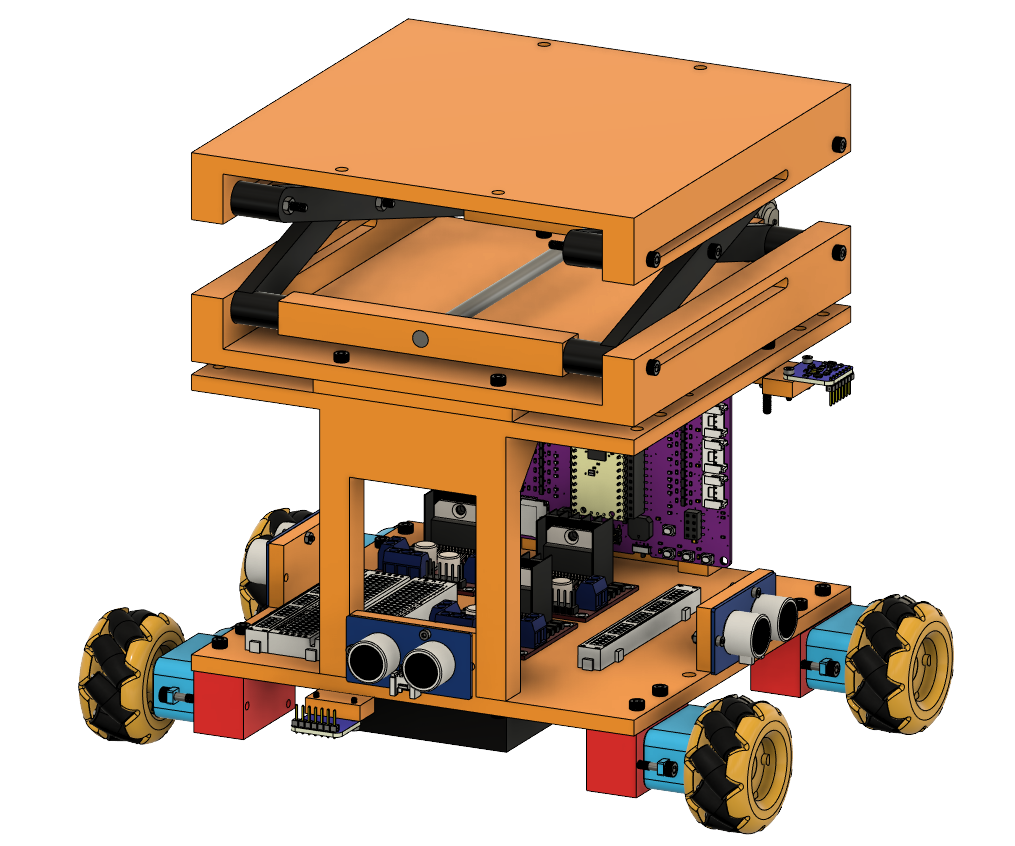

In the class this case is utilized in, there is a final project where our team is developing a robot that operates with mecanum wheels by utilizing the microcontroller and some sensors. My goal is to integrate this case in the final design in order to hold the microcontroller and further develop this project beyond just the case. We've also begun the configuration for a scissor jack on top of this robot to create a miniature electric vehicle charge bot (as shown above).
