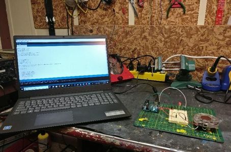

This project was intended to serve as a proof of concept for using a rotary phone’s dial as an interface between a user and the Arduino microcontroller. However, this experiment quickly turned into an opportunity to learn all about the Atmega328P’s various timer and interrupt capabilities and how to manually set registers within the Arduino IDE in order to utilize them.

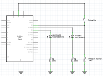

While disassembling a few legacy phones, I was excited to learn that their dials are completely self-contained devices that operates as a normally closed switch. When the user draws the dial back to a specific number the switch will periodically open that number of times, with specific timing that is dictated by the rotary dial’s inner clockwork. In order to test the possibility of using the device to act as a sort of keypad, the circuit depicted in the top diagram was constructed. Both LEDs have their own digital pins (D3 and D4) which are simply used to communicate whether the correct predetermined code has been entered into the dial. The microcontroller counts the low pulses at the rotary dials pin (D2) in order to determine which number has been entered.
Though the circuit is very straight forward, programming for this operation required an intimate knowledge of the Atmega328P’s timers. A timer had to be utilized in unique ways in order to distinguish one pulse from another, determine when to move on to pulses for the next number, and even debounce the switch.
The project has left me with a much deeper understanding of the registers used to control the 328P and consequently I feel very confident navigating the chips datasheet in order to use any of the registers or features I’m not yet familiar with.

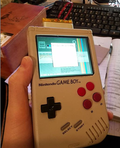

Affectionately called the Gameboy-Pi, this handheld console utilizes a Raspberry Pi Zero to run Recall-Box, a popular OS for running all sorts of video game emulators. What’s unique about this set up though, is that everything needed for a full gaming experience has been mounted inside of the shell of an original Nintendo Gameboy. Unlike the other projects in this portfolio, I followed various guides step by step to create the Gameboy-Pi. Despite this, the project still required many moments of improvisation and an advanced understanding of working in Linux systems.
The majority of the Pi’s GPIO pins are used to handle the input from the 13 buttons, five of which have been added to the Gameboy’s original eight. Two additional pins are used for Audio and Video respectively. The screen is a repurposed rear-view camera display, which receives a signal through an AV cable, while the speaker and headphone jack are driven by a modular class D amplifier circuit known as the PAM8403. Since Recall-Box does not default to sending audio or video signals through GPIO pins, various setup scripts had to be edited to accommodate for this display method.
The battery pack is a single Li-Po cell, which is stepped up by another Adafruit Power-Boost charger and mounted on the shell of an old Gameboy game. The 5v from the voltage step up circuit is present on the packs 2 copper pads, so that the system is given power by inserting the cartridge just like an actual Gameboy cartridge.
The completed system can be connected to any wi-fi network and accessed over SSH in order to add or update the ROM files on the system. This way, any game supported by Recall-Box can be added to the Gameboy-Pi at the user’s discretion.
