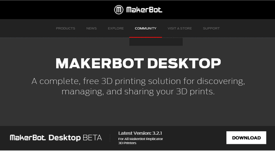

Go to www.makerbot.com/desktop
Click the download button

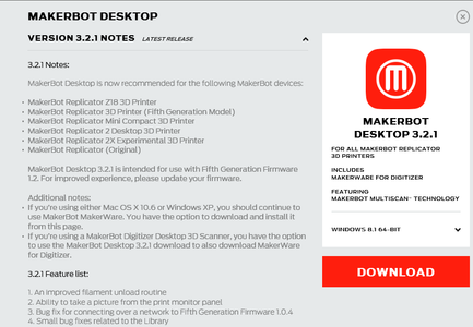

Step 3: MakerBot Desktop
Select operating system from drop down menu and click download.
Double click the MakerBot Desktop installer to begin the installation process.
Follow installation instructions.

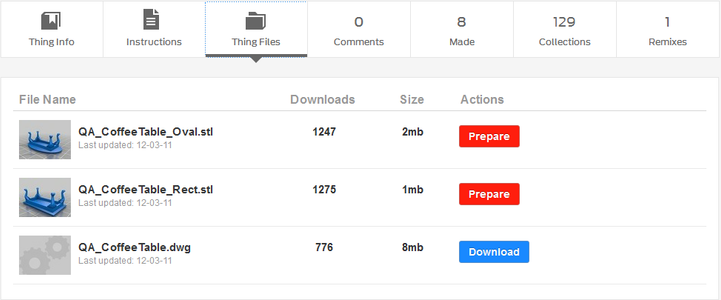

To print designs from Thingverse™ click on the “Prepare” button or click “View in Library” to see the design files in your library tab.
Thingverse™ account required to print designs from Thingverse™
Step 7:
Select Prepare for the file you wish to print
The prepare tab should automatically open and download the selected design
If you wish to add another design to the prepare tab simply navigate back to the explore tab or library and click prepare for that design file.

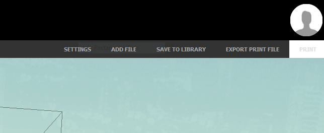

After the models have been placed and scaled to your specifications you can adjust the print settings by clicking the “Settings” tab in the top right corner.
You will be able to select print speed, resolution, and several other options that you will be able to optimize after gaining some experience.
The default settings should be sufficient for a typical print.
Step 12:

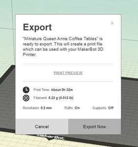

Once your layout and settings are finalized and you are done press the “export to print file” in the top right corner
You will get a popup that will tell you estimated print time and Filament usage
Click “Export Now” to save the final print file to a USB drive
To print, simply come to FirstBuild with your USB drive to see your designs created!
You may also choose “Save to library” if you wish to end your session and return later
