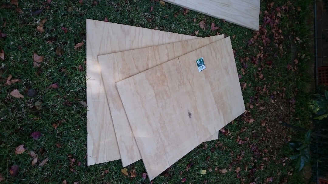

- Plywood - $33 (enough for both benches)

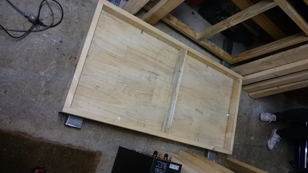

Step 3: Build the Top and Bottom Frames
These top and bottom frames support the benchtop and shelf respectively as well as provide the structure to hold the bench's rectangular shape.
Both frames are constructed from simple butt joints with two countersunk screws, one above the other, at each join (I recommend pre-drilling to avoid wood splitting).
I implemented only a single cross brace in the top frame (not pictured as I added it at a later stage) since the benchtop chosen was so solid and sturdy. If you are using plywood, I recommend two (2) cross braces.
I used two (2) cross braces on the bottom frame to support the plywood shelf.

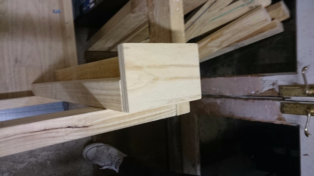

Step 4: Build the Legs
Each leg is formed from two pieces of timber placed in an L shape as pictured. These pieces are joined with three (3) evenly spaced screws.
Step 5: Assemble the Bench
I found that it was easiest to construct the bench upside down, building onto the benchtop and then flipping it over upon completion. This takes the weight off the legs etc while you are trying to assemble the bench, avoiding any unwanted deformation. The steps are as follows:
- Glue the top frame to the benchtop and clamp.
- Add brackets at intervals around the frame to further join the frame to the top.
- Add the cross brace to the top frame.
- Place all four (4) legs into their positions and attach with two (2) screws on each side (4 screws in total).
- Place the bottom frame over the four (4) legs and adjust to your desired height (remembering to take wheel height into account if applicable). Once adjusted, clamp the frame in place.
- Screw the bottom frame into place with two (2) screws on each side once again placed one above the other (4 screws in total).
Step 6: Construct and Install the Shelf
The shelf is constructed from plywood and has been put at a height which allows for users to put their feet on while sitting or standing.
**The trickiest part for this bench design is constructing the shelf to wrap around the legs seamlessly with as little gap as possible. While I think having the shelf the same size as the benchtop looks great, it really was a lot of work to cut the pieces out to fit around the legs and you could just as easily modify the bottom frame such that it sat inside the legs (so that the shelf could also sit inside the legs).**
Due to the sizing of the plywood sheets at my local hardware store and to save money, the shelf is constructed from three separate pieces. One large centre piece (at a width of 120mm which is a standard plywood width) and two end pieces which were fashioned to fit around the legs. I recommend using a single piece if possible as this avoid the ugly change in wood grain and obvious join!
