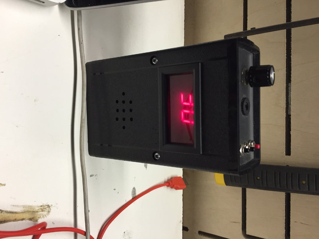

(I put a photograph here of my bat detector, but it is not necessary for this project. You can however find out how to build a bat detector online, and I recommend doing so if you like soldering and finding bats).

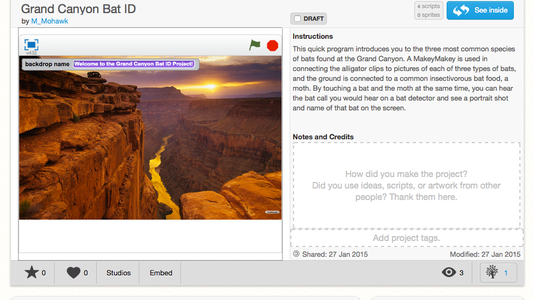

Playing with Scratch is the best way to become comfortable with how it works. Setting up the different icons to lead to different actions will show you how to use it even before you connect your MakeyMakey. In my case, I set up a couple different routines, which you can see in my program here. First of all, I created statements that allowed for the actions: "WHEN <certain key> is pressed, PLAY SOUND <certain bat sound> until done, SWITCH BACKGROUND to <picture of bat> BACKGROUND NAME of <name of bat>". Doing it this way with well-named files allows you to exactly see what will happen with each of these little routines.
My second routine was for the introduction and initial background screen, and was even simpler: "WHEN <green flag> clicked, SWITCH BACKDROP TO <picture of location where these bats live>, BACKDROP NAME (which shows the intro to the program in text)".
I recommend doing one full step before building all the rest. You'll want to test it with your MakeyMakey first in the next step.

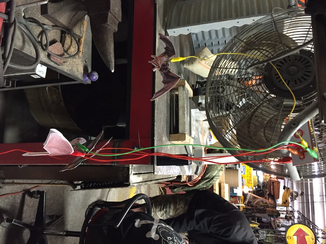

Now your first circuit is ready to go. You should have the MakeyMakey connected to your computer, your Scratch program open and live, an alligator clip between the specific arrow key and a bat's silver heart, and a second alligator clip between the silver MakeyMakey board ground and the moth's silver heart.
Do this by now touching a bat's silver heart with one hand, and the moth's silver heart it wants to eat with your other hand. Doing so should complete the circuit and run your routine. Connecting the bat to the moth plays its feeding sonar frequency and displays the bat's name and photo for identifying the bat through its image and sound. You now have a learning device for IDing this bat when hearing its sonar frequency!

Step 9: Hang Your Educational Mobile From an Appropriate Spot, and Teach Your Friends!
I used this project to show our workshop attendees how the MakeyMakey works, so I hung it from our welding equipment where they could see it as they came in. But you can hang it using something more attractive - put the MakeyMakey at the top, and use the alligator clips natural length as the way to dangle the bats. Keep your computer close by so you can turn up the speakers as needed!
