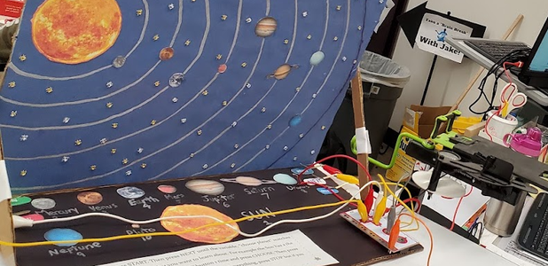

Here is my project. It's a relatively simple and easy to make one. The hardest part was figuring out how to be able to select from 10 different choices using 5 buttons.
This is basically a stand of sorts with the solar system on it containing some basic facts about the solar system we live in. This could be used for really young kids like in elementary school learning about the solar system or used as a quick and simple science project on astrology.

Step 2: STEP 2: Build the Physical Part of the Project
  1. Get a large piece of cardboard that can be folded in half - like to sides of a box
  2. Cut out the Sun, the 8 planets and Pluto
  3. Glue construction paper on the bigger half of the piece of cardboard or at least one of them
  4. Draw in the orbits with pencil and then trace over them with silver marker or any color that will stand out against dark blue/black
  5. Glue in the planets
  6. On the other half, glue construction paper over it with either the same color or a different color (preferably still dark blue or black because space is usually shown like that) and cut 5 slits with an exacto knife on the side by the edge and put in conductive pins or paperclips in a way that the pins/paperclips won't move
  7. Cut out the buttons and label which ones are going to be START, STOP, RESET, NEXT and CHOOSE
  8. Cut out bigger pictures of the planets + sun + Pluto and label them with their names and how many times to click the NEXT button to get information on that planet
  9. Put in instructions on how to work it if there is space, if not edit the code so that the start button will say the instructions
  10. Decorate and make the project look pretty with whatever tools you have
Step 3: STEP 3: TEST YOUR FINAL PROJECT
  1. Insert the USB mini end of the cable into the USB mini slot of the Makey Makey.
  2. Insert the USB end of the cable into your laptop or Chromebook.
  3. Go to the Scratch program and see inside
  4. Attach alligator clips from the up arrow, down arrow, left arrow, right arrow and space key to the buttons as your code says to
  5. Test all the buttons if they activate correctly and then check if all of planets/sun/Pluto works
  6. Adjust when needed
