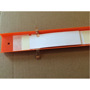

Use your ruler to measure the width of the track. Mark this width along the five inch length of the index card.
Step 3:
Make a second mark the same width as the first. Cut both strips from the index card.
Step 4:
Use masking tape to affix one of the index card strips to the track.
Step 5:

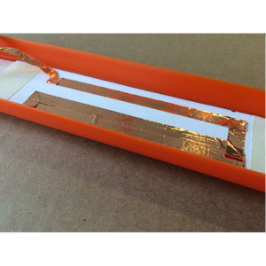

Use conductive copper tape to build two strips on the index card, making sure both strips are connected. Try to place the strips where the car’s wheels will be when it travels over the switch. Leave extra conductive copper tape at the end of the strips to give you somewhere to attach the alligator clips.
Step 6:
Place the second index card strip over the first. Use a pencil to mark where the two conductive copper tape strips start on the card below.
Step 7:
Build two additional connected conductive copper tape strips on the second index card strip. Leave extra conductive copper tape at the end of the two strips to give you a place to connect the alligator clips.
Step 8:
Insulate the extra conductive copper tape on the lower strips with a piece of masking tape.
Step 9:
Use the ruler to help you bend about 1/8” of the second index card strip back toward the conductive copper tape strips. Bend the end opposite the extra “hookup” strip of conductive copper tape.
Step 10:
Line up the second index card strip over the first, conductive copper tape strips facing down. Use masking tape to affix it to the track.

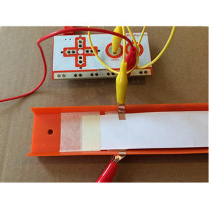

Step 11:
Connect one of the extra conductive copper tape pads to the Earth of the Makey Makey. Connect the other tape pad to the Space key on the Makey Makey.
Step 12:
Scratch linkhttps://scratch.mit.edu/projects/86672611/
Click here to remix this project in Scratch
When the car drives over the air-gap switch, Scratch detects a Space key being pressed and animates the car Sprite and plays a sound. Additionally, it starts a timer that counts every second and displays it on the screen.
