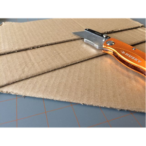

Step 1: Cut Cardboard
Use a box cutter to carefully cut two pieces of cardboard the same size. You can easily accomplish this by selecting a box with the flaps intact and cutting matching flaps from the box. Cut a third piece of cardboard that is the same size as the other two, or cut strips of cardboard about an inch wide. You will use the third piece or the strips shortly, so set them aside.

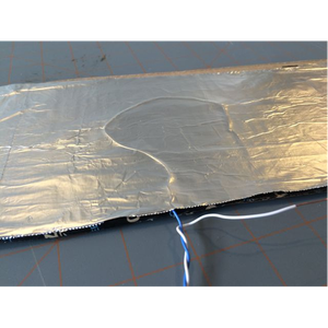

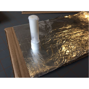

Step 2: Tear Aluminum Foil
Tear a piece of aluminum foil to roughly the same width and length of the piece of cardboard.
Step 3: Glue
Use a glue stick to adhere the foil to the cardboard.

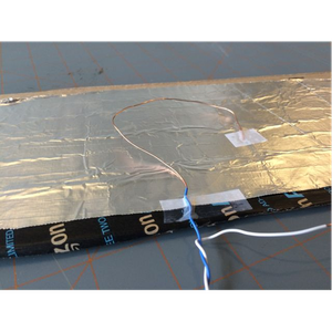

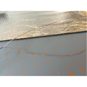

Step 4: Strip Wire
Use the wire strippers to remove about eight inches of insulation from the ends of two pieces of wire.

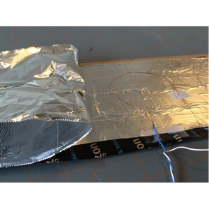

Step 5: Tape It
Use cellophane or masking tape to affix the wire to the edge of the cardboard. Use a small piece to affix the end of the wire to the aluminum foil.
Step 6: Wiring
Cover the wire with a second piece of aluminum foil. Use the glue stick to adhere it to the lower layer of foil.

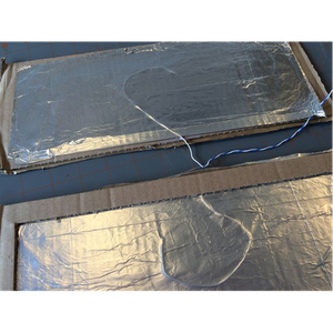

Step 7: Build the Second Half
Build the second half of the switch according to directions 1 ­ 6, using the second pice of cardboard.

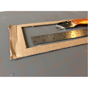

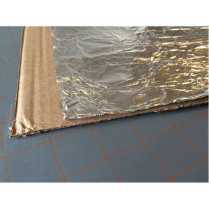

Step 8: Picture Frame
If you have a third piece of cardboard as opposed to inch wide strips of cardboard, use the ruler and box cutter to remove cardboard from the middle of the sheet, creating a “picture frame” from the cardboard.
Step 9: Glue
Glue the frame to one of the sheets of cardboard covered in aluminum foil. If you are using cardboard strips, glue them to the edge of the aluminum foil-covered cardboard.
Step 10: Glue to Top
Glue the second sheet of aluminum foil covered cardboard to the top of the cardboard frame.

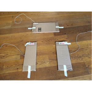

Step 11: Repeat
Build at least one more Makey Makey game pad using steps 1­-10. If you want to have players physically jump, consider building a third game pad.

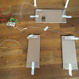

Step 12: Connect
Connect the game pads to the Makey Makey with alligator clips. Connect the Makey Makey to the computer with the USB cable.

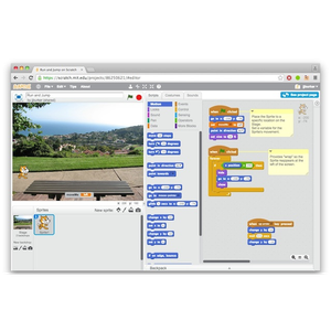

Step 13: Scratch
Remix this Scratch project.
It uses the left and right arrow keys and a variable to make the Sprite run across the screen. If you have a third game pad, you can connect it to the Up arrow: jumping on this pad will make the cat jump, too.
Scratch linkhttps://scratch.mit.edu/projects/86250621/
Click here to remix the project on Scratch
