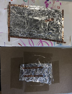

Step 2: Make the Internal Connections
Using tape, attach aluminum foil to 1 sheet of card stock and the uncut foam board.

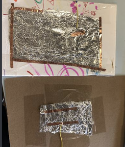

Step 3: Set Up the External Connections
Strip the ends of two 8 inch wires and use copper tape to connect each one to the aluminum sheets.
Step 4: Continue the Internal Connections
Tape The Card Stock With Aluminum Foil To The Cut Foam Board So The Foil Is Facing Towards The Hole.
Step 5: Attach the Pieces
Tape The Cut Foam Board And Card Stock To The Other Foam Board So The Aluminum Foil Sheets Are Facing Each Other.

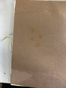

Step 6: Make It Look Nice
Draw whatever design you want on the second sheet of card stock and tape it over the other sheet of card stock.

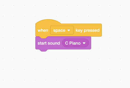

Step 8: Create the Code
In scratch connect the "When __ key is pressed" and the "start sound __" blocks. Then in sounds choose a sound that you want to play and select it in the "start sound __" block.
